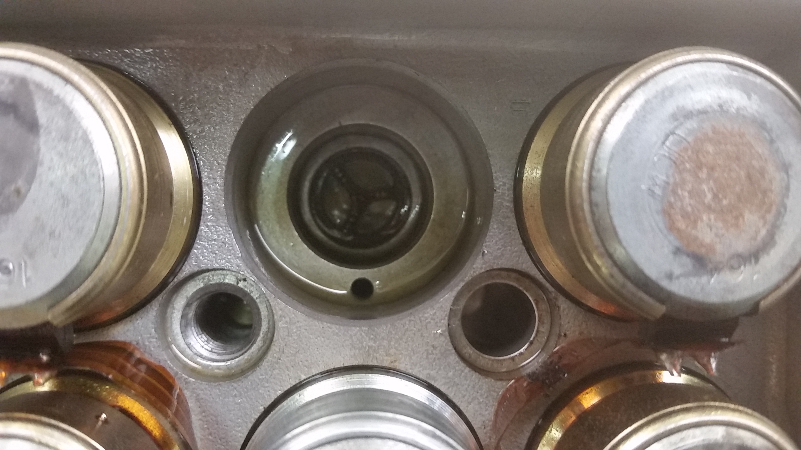

Hi Gerry
Your ABS Master Cylinder Actuator looks exactly the same as mine, so that is a good start.
But before you take the Valve Block apart (only 4 nuts Lol) bear in mind it could be something else.
(1) A Stuck/Sticking Caliper (although I believe you said you fitted New ones)
(2) A Wheel Speed Sensor
(3) A Sticking Brake Pad. (especially if you have fitted New ones)
I'm not an expert on Wheel Speed Sensors so your best bet is Warrjon or Videos on YouTube.
As for a Sticking Brake Pad, it could well be that as there can be a slight variance depending on where they are made.
So they may not be a good fit, straight out of the Box.
In which case I always grind a bit off the Top and the Bottom of the Metal Backing Plate, so they slide in and out very easily using only your fingers.
This Brake Pad was such a tight fit that I had to grind 0.5 mm off the Top and Bottom of the Backing Plate, so it would easily slide in and out using only your Fingers.
Grinding a bit off the Top and Bottom of the Backing Plate, so that the Pad would slide in and out using only your Fingers.
First I cannot say for sure that you have a problem with the ABS Valve Block, its up to you and the Garage to determine the cause of your Braking Problem.
Also there is no Guarantee, that this Fix is going to Work as a lot depends on how bad the Valves are inside.
(or whether the Valve Block was the cause of the problem)
So when you've tried everything else you can think of, then you can try this.
I'll give you the Shortened Version First to give you an idea of what to do.
(1) Remove the ABS Master Cylinder Actuator (including the Brake Pedal as one unit)
after De-pressurizing the System and draining all the Brake Fluid out of the Reservoir.
Apart from undoing the Brake Pipes on the Unit, there are only 4 Bolts holding it in.
Have lots of Towels and Soapy Water at the ready because Brake Fluid could run everywhere (even when the Reservoir looks empty)
Don't let any Brake Fluid drip on the Paint Work, or it will destroy it in an instant!
(2) Once the Unit is out of the Car, lay the Master Cylinder Actuator on its side so that the Valve Block is Facing Upwards.
(3) Before you take the Cover Plate off, you need to know what you will find inside.
Which will be 6 Steel Valves joined to the Plug on the Side with Ribbon Connectors.
These Ribbon Connectors are so Fragile, that even touching one could break it off.
So having Very Carefully removed the Cover Plate, you may find that one of these Ribbon Connectors has Broken off from one of the Valves.
If so that's your problem right there!
But before you touch anything, do a drawing of how these valves are Wired into the Plug. Double Check It: DO NOT GET THIS WRONG! for obvious reasons.
The Valves themselves lift out and will need to be Cleaned in an Ultrasonic Cleaner
On the Assumption you don't have one, take them into a Jeweler and ask them to clean them for you, as that's what they use to Clean Jewelry.
Dentists also use these as well, so you could take them there and ask a favor.
Having got the Valves Clean, take the Valve Bock and the Valves into a Radio Shop with your drawing and ask them to Re-Wire the Valves into the Plug using Wire.
In other words get rid of the Ribbon Connectors and use Wire instead.
Obviously you could do this yourself but you need to be Ace at Soldering, as if a Wire comes off then its 'Game Over'
So best to leave this to the Guys who do this every day and know what they're doing.
Then after reassembling, basically that's it!
And then just a question of refitting the Unit and Bleeding the Brakes.
Before you remove the Master Cylinder Actuator, there are some Electrical Tests you can do, which are outlined in the longer version.

I appreciate your advice...looks like work ahead.
Fortunately this car is a play car and is seldom driven...that in itself may be the problem, but it can be under repair for a while with no problem.
I haven't really checked this out but are you saying that by removing four bolts in the engine compartment the entire assembly, including foot pedal can be removed outward through the firewall?
This may be a time when education and experience in my very early career will be beneficial. I'm not worried about performing the soldering as I was a licensed commercial broadcast engineer years ago and built about twenty Heathcraft projects including a color television that required hundreds of non-cold soldered terminations. Also, I still have most test equipment stacked away somewhere.
I doubt if it's the calipers or pads. I replaced both front calipers early on in this saga. Had planned to replace pads but the parts house shipped the wrong pads so I installed the old and they fit well. Also hoses were replaced on the front. This is an intermittent issue.
When this didn't fix the problem I took the Jag to a commercial shop. They replaced the right front caliper again...still no better.
That brings me up to date and have suspected for a long time that a proportioning type valve must be the issue.
Again, thanks and will report back after getting this in the que for priority.

Today I decided to check out the "spare" ABS block and opened it. One trace lead of the ribbon to what I have numbered #6 is broken...all solenoids click when energized with 12 VDC. Rewiring seems to be straightforward and will attack that when I pick up some wire. Want to be sure I have a 40 strand, silicone insulated for high heat and only have household on hand.
I don't want to damage the circular screens located beneath the solenoid valves. They didn't pop out with a gentle pull, how are they retained or what is the trick, or should they be left alone? I'll attach a couple pics.

That Valve Block looks in great condition (Nice Find!)
Those Ribbons go 'Crispy' with all the heat and as such would only take a little jolt to break them, as you have seen for yourself when you opened it up.
As for getting those Filters out, I very carefully hooked them out with a Watch Makers Screwdriver but if mine had looked as clean as yours.
Then I may have been tempted to leave them alone and just run some Brake Fluid through them, so its your call on that, except whatever you do don't damage them.
Having looked at those Photos, I'm very Tempted to say that unlike on my V12 Car you have a lot more room to work around the Master Cylinder Actuator than I did.
So if you are very careful, then it looks like it 'MAY' be possible to just replace the 'Valve Block' without taking The Master Cylinder Actuator out of the Car!
The only thing to watch out for is those Big Valves falling out under their own weight as well as not losing the rubber sealing strip gasket for the plug.
I definitely think you can do it this way, which would be a lot better, than Tearing everything down as you seem to be a Guy who knows what he is doing.
So its gotta be worth a Shot.....
Just watch out for 'Paint Destroying' Brake Fluid running everywhere, so pack plenty of Towels around where you are working and if they get any Brake Fluid on them.
