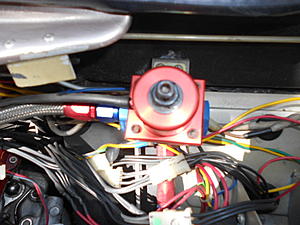

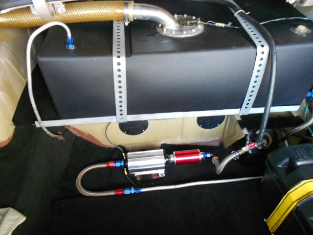

or you could do it better than all said!!
new hi volume fuel filter and fuel pump stainless steel flex lines ,Aeroquip lines and high pressure fittings(rated 1000psi ) ,should do the trick ,and last for rest of your life!
adjustable FPR , you set to run any injector combo pressure, fine tuning!
nothing is to good for my baby,LOL.

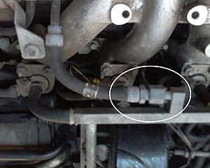

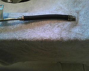

Doug
That is sort of true; but as I remember 9could ne wrong) on my car those "Ferrules" were solidly attached at the threaded end of the fitting, in as much as they were somehow crimped at that end into an annular indent in the fitting; sort of U shaped on cross section with a hole in the bottom of the U that was located into an indent. So to remove them the metal ferrule had to be cut and prised apart. I do not think it could be just pulled off, even with no rubber hose there. Open to correction, as always, retirement memory being what it is...
Your memory is fine.
On the injectors the ferrules will just drop off once the hose is removed. On the feed and return lines they won't; they are crimped (or similar) to the pipes
But what I'm trying to say....but not very well....is that the fuel hoses themselves are not crimped on.
I've attached some pics
The first two pics show original lines. Notice that the collars/ferrules have no tool marks; no crimping of the hoses.
Next is a pic of aftermarket/'rebuilt' hoses from V12 performance. They decided to crimp the hoses into place; the crimping/tool marks are clearly visible even if the pic itself ain't so great
Last pic is one of my own fuel pipes; hoses simply pressed-on and using the same (smaller) ferrule as used on the injectors.
DD
Attached Thumbnails Engine Bay Fuel Lines...Alternatives?-fuel-pipe.jpg   Engine Bay Fuel Lines...Alternatives?-fuel-pipe-2.jpg   Engine Bay Fuel Lines...Alternatives?-fuel-pipe-4.jpg
JayJagJay (05-06-2018)
