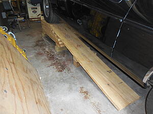

9- 2 X 12 X 24 long, stacked glued and screwed, top board is 22" long for a lip to screw a 2 X 12 X 6 foot for ramp with 3- 2 X 12 strips stacked midway for support. Installed a stop so wont go to far.
Bottom of wheel is 15" off the floor. chocks behind front and rear wheels. 2 closet door mirrors so I can keep my eyes on the wheels as the car goes up.
Put in drive and it idles up the ramp, after the car is up remove the ramps.
I like knowing I'm completely safe underneath as I work alone.
Also works for the other 4 vehicles.
Will take pics later
2- 18' 2 X 12's and 1-12' 2 X 12

15" is not high enough laying on creeper,will be adding 3 more inches.
When I have the finished product will take pics.
Thinking next to my shop building,making concrete ramps 24" tall and long enough to drive Jag and other vehicles to get all 4 wheels on ramp and also concrete between the ramps so I wont be on the dirt.

Default Pics of ramps
Added a 4X4 and 2X12 screwed to the bottom got some more
height.
26" to bottom of spoiler
