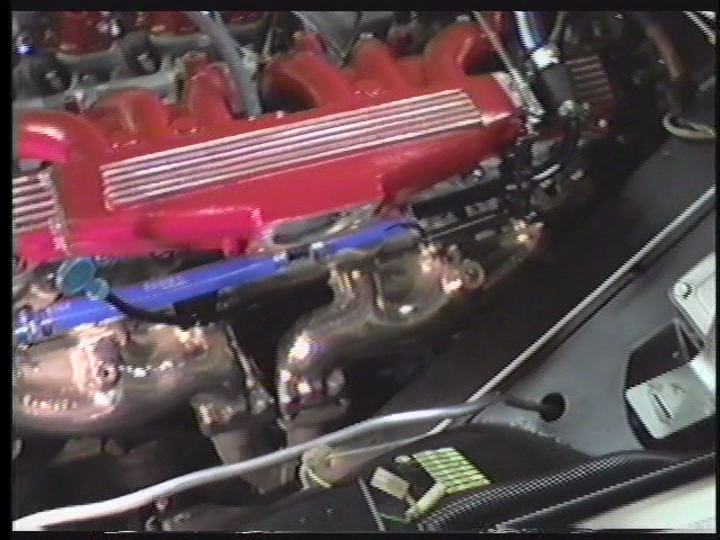

exhaust manifolds ,1st ported & smoothed internally,then Ceramic thermal coated.
then inlet manifolds EXTRUDE HONED, very smooth and takes out the internal humps and bumps, injector protrusions, also opened up 1/8th inch alway thru, including the plenums!
outside painted RED, fins smoothed off for visual effect!
24yrs later , still looking good, better resolution also!

that coating does not hold up to exhaust manifolds and turbo housings ,it actually starts to melt off when it GLOWS RED>ORANGE!
N/A engines it works fine cooler temps, but at tubing bends it changes visual, been there done that!
still looks better than raw iron tho.
