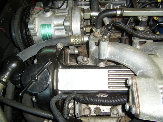

Mine with the Sanden conversion.
ALL spark plugs are simple on a cleaned out V, but the fact you can see the front 2 and actually use a "normal" socket arrangement on them, is a bonus.
