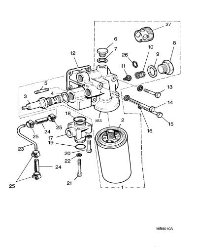

I have a 90 XJS convertible. I got a lot of oil loss on the interstate the other day. After filling the oil back up, I got it home and found a very short rubber hose that snapped just above the oil pan. It is in a very tight spot and I have been trying a variety of methods to get at it.
Does anyone know of an easy way to fix this without having to take the rack out?

That's a tight area to get to. The rack can actually drop several inches, fairly easily, without being removed. Doing that may give you the extra room you need. Unfortunately, it's been several years since I had to do that, but, it seems that you can do it by removing two of the bolts that secure the rack bushings.
If that doesn't let you get to it, you'll have to also remove the downpipes on that side. One of the few tasks that suck worse than removing the downpipes is putting them back on. It seems that at least one of the 4 studs on the manifold is located in a place which makes threading that brass nut onto it, nearly impossible. Patience and persistence are the keys.

Tony, you mention "that hose", as in singular???. There are 2 small hoses in there, one on each end of that metal pipe, UNLESS the USA market cars are different to ours??.

assuming its a v12
imo you chould take the whole filter head off as there are o rings that will need the same attention due to age I had the same thing on mine and while the rack is lowered (in your case) it would be short sighted not to do them.
all still available from jcp

Well this is the pits, but I was out and about yesterday and noticed that my oil leak (from the same area) seems to be back. I made sure there was oil and got it home. Put it in the garage and will ask Santa (aka Father Christmas) for a couple of ramps to drive it up on (actually, he already dropped them off). Likely won't get to it until after Christmas day.
Assuming it is the same hose again, I was wondering if there is any special type of hose to use? I used a narrow fuel line that was a tight fit over the spouts. Should I have used something else?

Fuel hose would be OK to get you home from, say, Vegas. It will not last long, sadly, as it is simply not designed for oil.
I use a Pirtek 6mm Red oil hose, rated at 1500psi (a tad overkill, but it is OIL hose), with EFI005 clamps. Pirtek is a hydraulic mob down here, along with Enzed, and are within walking distance of my work.
My HE has had them there since 2000, and still soft are pliable, last time I changed an oil filter. NO oils leaks on that beast.

This may be a silly question, but if I use the hose you recommend, do I still need to use the metal tube in between?
I found the company you mentioned located in Phoenix, AZ or Denver Co. Their specs say the hose can stand up to 300 plus degrees. I assume the metal pipe was to handle the heat between the hose lengths.

I see NO reason for that metal tube, never have worked out why it was done that way.
My warped sense of humour, loooooooong time ago, decided it had 2 hoses, with 4 joints, to allow for more oil leaks. Made perfect sense at the time, and still does today.
Mind you, I have NOT deleted that pipe on any of my V12's, just replaced the hoses with that Pirtek stuff, and never ventured to that area again.
Maybe the "British non-metallic" component, the hose, back in the '70's was of poorer quality to what is available today, so 2 short straight sections, with NO bends, was seen as as the lesser of 2 evils.
