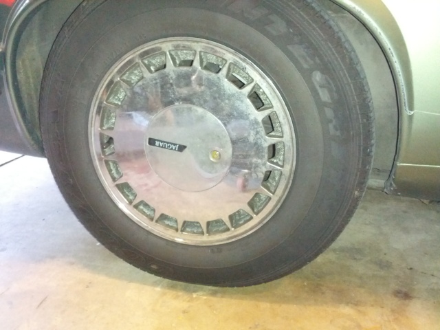

3. Rims on the car are somewhat unusual. Thinking of having them replaced, but also consider refurbishment. The chrome is pitting, as well as the underlaying alloy in certain areas. Would a decent chrome shop be able to refurbish?

The rims may be salvageable depending how bad the pitting is and how picky you are about how they look. Re-chroming can be expensive, but yours may not be chrome, they may just be polished. Check around your area, you may find a shop that can refurbish them. Small shops that specialize in wheel repairs are starting to pop up because of the popularity of oversized rims with rubberband tires. They get bent and damaged quite easily!
