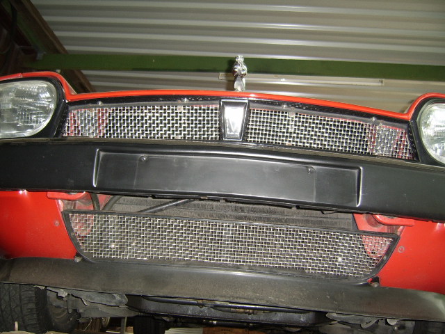

Biggest issue with the real engined cars is the air "getting out" of the engine bay.
As Greg has said, most of that crud is "sucked up" by the engine driven fan, and not via the front intake. If it were via the front intakes, the a/c condensor would be clogged, and I have never seen one of them clogged in that way.
The exit air from the engine bay is generally restricted by the thick foam pad that is up on top of the transmission, and originally glued to the tunnel, but that glue has long given up.
I have not had the radiator seals/foam fitted to any of my V12's since about 1994, and the temps are stable in any weather, even our 45+C summers.
AHA. but I run E Fans on them all in lieu of the factory engine driven fan/s.
Also still have the a/con fitted and working.
Those rubber flaps in the factory shroud did do as you described. a very long time ago, but most (and yours may not be obviously) are hard and bent towards the engine and do not close at idle as designed.
I also have "cold air" intakes that collect air from down under the front bumper bar.
Those factory snorkel trumpets are sucking HOT air from the radiator system, and that is OK for economy, but COLD air is OK for power. I wanted the power, and the economy has not suffered at all, 11.2L/100KM generally on interstate runs.
My grille set up, that I made myself.

You are right Grant, I did notice that the condenser was not clogged. I was intending on putting the foam seal back in place, but now I am inclined not to.
I have new thermostats (82 degree), and I am taking the radiator in to have it professionally sorted. The inside of the radiator seems pretty clean. Hopefully, a good flushing is all it will require.
In the future, I see switching over to two electric fans, but right now I don't want to be in over my head while all this other sorting is going on.
