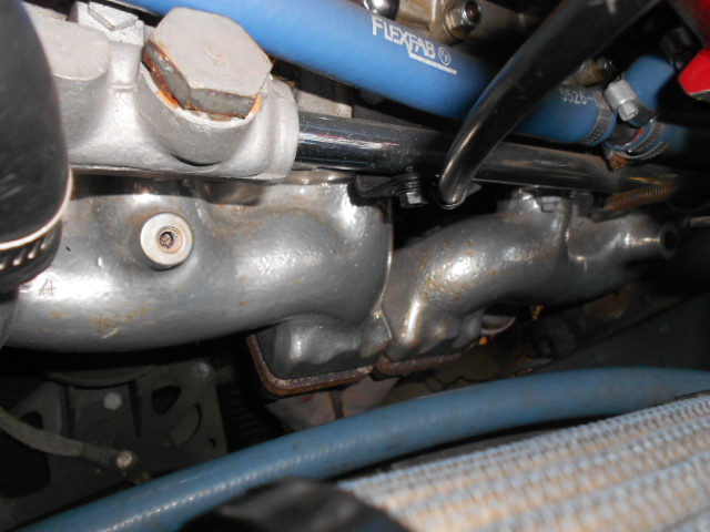

I have only ever seen damaged/cracked/broken V12 exhaust manifold where some CLOWN has done so trying to get the pipes out, never cracked from casting issues.
I reckon your guy is covering himself, and prepping you for a HUGE $$ bill to do those gaskets.
The exhaust manifolds do come loose over time at the head mounting area, hence the gasket issues, then add to that the restrictions that build up in the system (blocked cats/mufflers/etc) as the exhaust components age, put undue pressure on the weakest link, the gaskets.

I agree, if the gasket is bad, you will have a leak there. The weakest point already broke, so why would the manifold be cracked?
I would say you are correct in thinking there is no point in expanding the rest of the system larger than a bottleneck further up the system. If you are getting a custom exhaust there shouldn't be any harm in increasing the size a bit, but it won't do much for you, like others have said.
As for the 1.75 manifolds, you have to remember there are two of these split between 3 cylinders on each side, so that 1.75 isn't a bottle neck. The smallest point starts where those converge as long as it is smaller than 1.75 combined.
The aerodynamics and flow are obviously more complicated than just saying 1.75+1.75 but this is just a street car, so it is good enough for estimating.
I would be more concerned with higher flowing cats and other parts of the muffling/silencing system to increase power than an extra 1/4 of room in the exhaust pipes. If you can delete those or upgrade them to higher flowing, it would probably have a more dramatic effect than slightly larger pipes, as would getting down to two mufflers instead of four
If you are talking 1/8-2" vs 2.5" it is a little more considerable, but still those cats can block up a good bit, especially old ones

Got a third opinion today. Going to the exhaust shop as planned didn't go... as... planned.
Ended up back at my old mechanic's shop, and they were willing to take on the job, saying they had someone who "might just be crazy enough to do it," though they did warn me it would be expensive. This I knew. Problem is, they couldn't find the gaskets.
My local shop didn't want to take on the job, fearing that - should it not go according to plan - it would just become too much for them to handle. Somehow, they were able to order the gasket.
I did some research, and expected one gasket per manifold, and instead found that the gaskets were a bit less elaborate.
It seems number 3 up there, the current part number being EBC10199, is what I'm after. Endless cross-referencing has found a couple aftermarket solutions, such as , (they're apparently the same company,) and finally , which has apparently been discontinued.
I don't want to do this on the cheap (believing that one gets what one pays for, even though all of these options save for the genuine OEM part are less than the $75 per side quoted by my regular mechanic,) but I also don't want to wait for a package to come in from overseas.
What's my best option here? Are there alternatives I should be considering?

Hopefully they ordered three gaskets, might as well change them all on that manifold if it has to come off.
You can do this yourself in your garage with not any specialized tools, but it is NO FUN and will eat up an entire weekend (then again, you'll save a lot of money). I've had all of my manifolds off (and had them ceramic coated). The rears are more difficult than the fronts, so it's going to be a job.
When one of mine blew a gasket I didn't want to wait a week for parts, so I just made some with thin sheet copper. Two years later they seem to be holding up well.
I understand that you feel like you are running out of options, but I'd be concerned about the shop's attitude that it may be "too much for them to handle". Where does that leave you...with one manifold off and an unusable car and a big bill for nothing???
