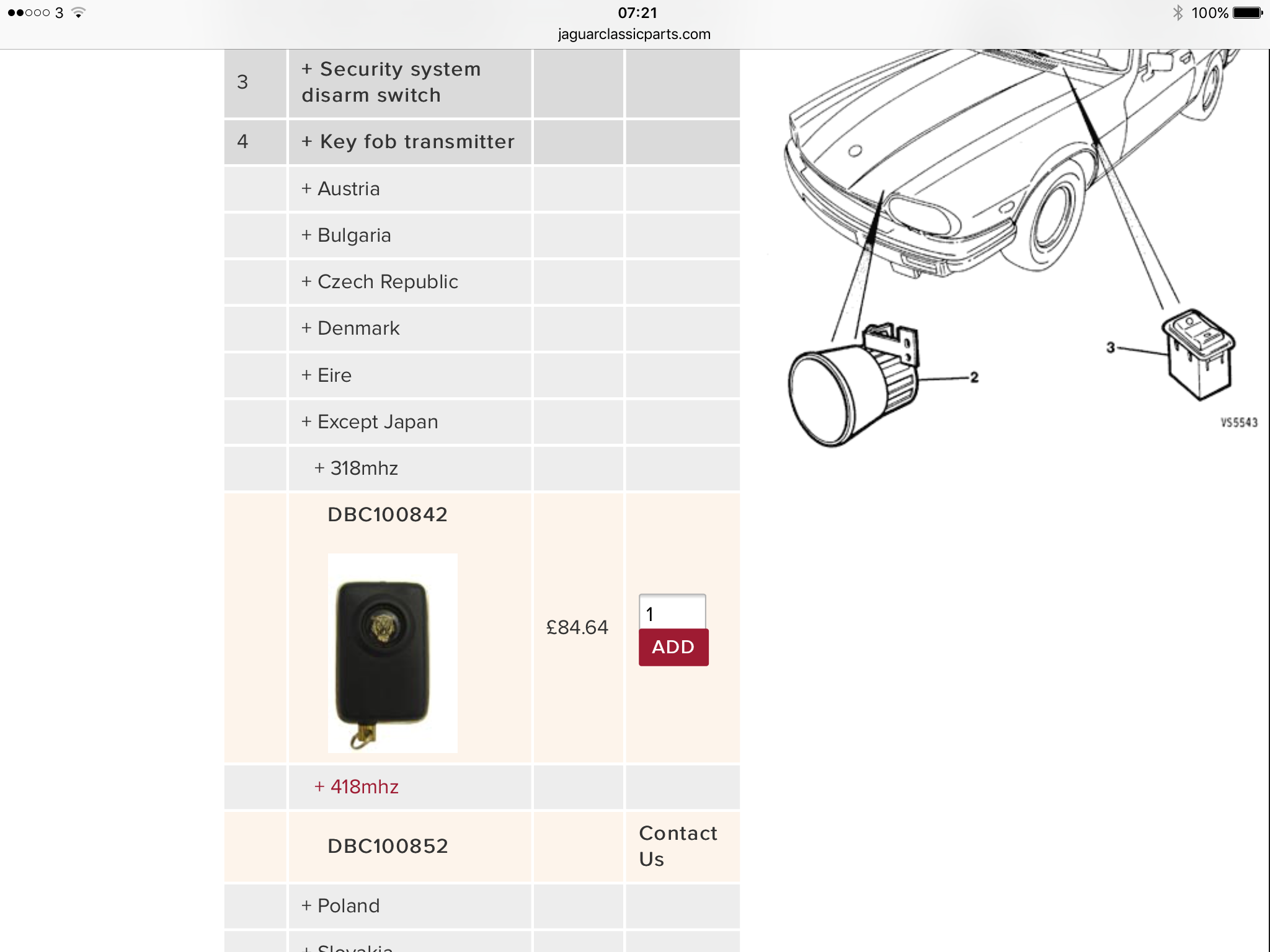

Beavis,
If you got the vehicle care handbook when you bought your car that should show you the style of remote fob you need - the cases were pretty fragile & it's possible a previous owner swapped the correct working circuit board into the wrong case.
Model Year is largely irrelevant here in the UK - we're more into year of registration but if your car is a mid to late 1992 registered car it would be classed in the USA as a 93MY car. Are the last 6 digits of your VIN higher than 179737? If so I'm confident that the part you need is this:
Rgds.
A.

Old 05-09-2016, 02:20 AM
malc4d's Avatar
Join Date: May 2013
Location: Orlando
Posts: 1,609
Received 442 Likes on 385 Posts
That one works on 318 MHZ. as far as l know we used 418 and later 433 here in the UK. So it will be one or t'other.
My car (1800** 1991 early facelift) has the UK alarm system which l bought new from Jag. and fitted as a plug and play kit, and uses dac 7990 as shown in the OP photos. I have sent him the Jaguar installation and user leaflet that came with the kit.
He will find out if the Feq. is correct as soon as he reconnects the Neg. bat. lead and the remote will be recognized (answer beep) or not (no answer beep)
Simples....Hopefully one of us is correct and it solves the problem...
