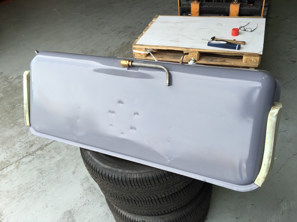

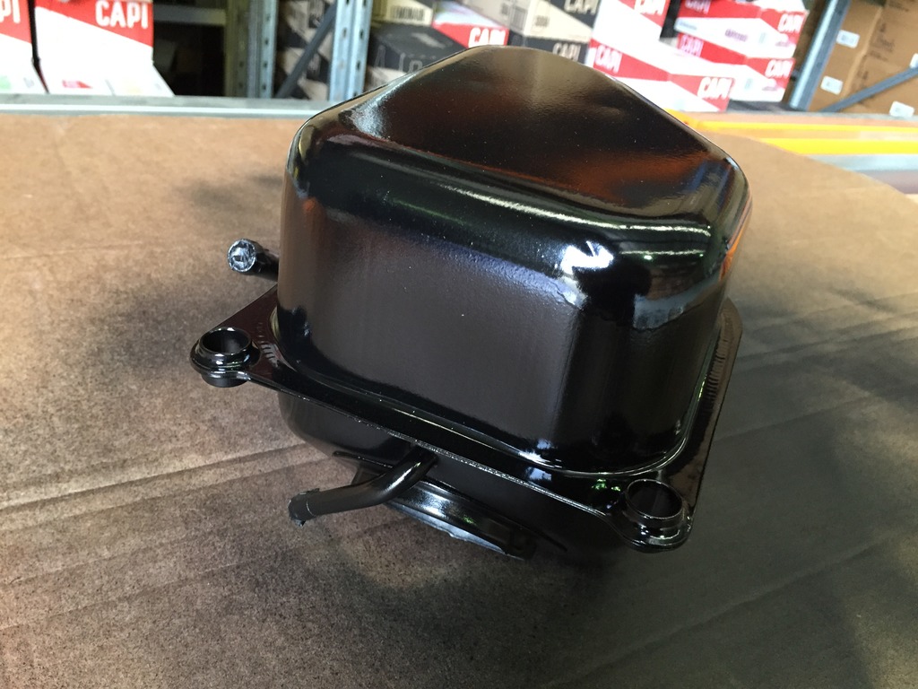

Again with the cleaning, nothing new just trying to get back on this horse, or cat.

Removed the fuel tank and swirl tank(?) had them alkaline dipped to get rid of at least 2 decades of stale fuel. Fitted a new filter, gave them a rub down and paint before reinstalling.
