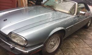

I am Brand new to the forum and was hoping for some advice.. I just purchased a 96 (I 'think' xjs) V12 convertable from a friend. the body is in great shape, and the car had been in a garage for all of its life, except for the last year. a squirrel had taken up residence in the engine bay and decided the bonnet heat shield is fantastic bedding material. I know the car ran well when stored on the side yard but obviously we have some unknowns.. I think (or perhaps "hope" is a better word) that the price i paid gives me wiggle room. I paid $4,000 for the car, i felt that was fair based on listings i saw for cars in good running condition. If fresh fuel, new battery and some TLC are all it needs then im in luck, but I would still think I would have a budget for some repairs without being upside down.. thoughts?
the one thing the owner noted was an E-brake switch that would not allow the top to lower, unless it was switched to accessory.

That's not a 96, looks more like a 91-92. What does the VIN sticker say in the door jamb? It is an XJS.
The top can only be raised or lowered when the handbrake is on, the car can be running or in accessory.

92-96 is the "facelift" version, it has a different front bumper. By 96 the V12 was "Special order only" and not sold in the USA. It was available in select other markets. Do you know if the car has a 3 speed or 4 speed transmission? 5.3 or 6.0 engine?

Agreed this is Not a 96. Also note the Chrome Wing Mirrors and Chrome around the Headlights... If this were a V12 96 those would be the same color as the Paint.

That's a facelift V12 5.3 convertible built sometime before April 1993.

For $4,000 you Stole it!
If that Photo is anything to go by.

By the door handles its not '91 -(92 my) they had the older style handles, most prob '92 -93' build.

Update: checked the door tag and it was manufactured in April of 92. I got a fresh battery, and hope to get it hooked up to a code reader and at least see if she turns over.. from there, the fun process of seeing what codes she may throw, and start to identify and resolve. Added a better pic of the car.
