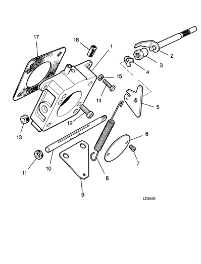

Out on a limb thinking. The splined arms at the rear of the horizontal shafts, just where the bushes go, may be ill adjusted, BUT, with the rods OFF they do NOTHING, and then only affect WOT angles if they are out of whack.
Are the throttle bodies clean????.
Remove the stop screws, carefully close the discs, and ensure they actually close off. Dont be dumb here, as the discs will jam in the housings, and then damage can be done unjamming them.
Unless plate #5 is not fitted to the spindle correctly., I still cannot get my head around this stop screw #14 being too short, it is simply not possible.
A real outside suggestion, and I have NEVER seen it in all my years. Item #13 is the bush/s for the spindles, 4 per car. If they were worn to the ridiculous, then all sorts of weird stuff would be going on, but as I said, I have NEVER seen them worn very bad at all. Seals #11 missing/worn, hell yes, but causing no issues of any real concern.

Attachment 202386
