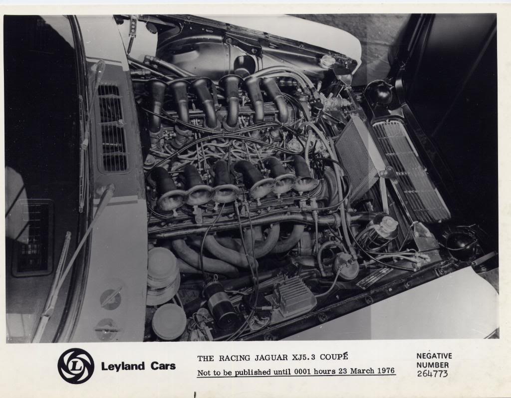

Broadspeed XJ12 manifolds

That second picture really proves the point I made on the '12-stack EFI thread on the underside of the hood on a race car just a few minutes ago.
Thanks for that timely post Warrjon!

can you explain a little more how the broadspeed intake is setup?

No Idea only had the pictures. Although I think those runners are way too short for a road car.

The inlet stubbs have flanges and go straight up. the plenums have a top and a bottom part, the bottom has 6 holes to take the subs + a little more to allow good alignment. The cast bell mouths (velocity stacks) are beautifully machined to give full 180 degree edges and push onto stacks they seal with a viton 'o' ring in the middle of the slide fit joint. the stacks fitt to the bottom section of the plenum with 4 x 10/32 screws fitted from the underside of the plenum and equally spaced at 90 degrees around the bottom of each stack. Looks like the very best of F1 intakes available at he time. The top section of the plenum functions simply as a lid, it is located with loads of 10/32 screws on the cast lip around the edges, The parts are all none sided, the cast lugs for the throttle cable are simply cut off on the one side and left on the other. If you look carefully you will see a metal square in the center of the 2 sides. This locks the 2 plenums together so each side dosent drop (remember they are just an interference fit on viton 'o' rings) there is a hole in the center of this plate which takes a bolt or peg which is mounted at the bottom on 4 central main studs, this peg either has a nut or a clip to retain the plenums set up in place ie so it doesnt pop of like I found happened on a backfire.
The injection is Lucas metering unit. Designed by a guy called Bob Blerton. Bob's thought process was just simply somewhere else on this gear. Took me 2 weeks with the unit in front of me to see how it worked and many months after that to appreciate how well it worked. Simpler versions of this unit were used in F1 for years and at Le Mans until about 1988. As good as any EFI on full throttle and better / more reliable than most. But a precision instrument costing lots to produce. The tolerances where so fine that on a cold day you needed to pour a kettle of water over the metering unit and wait 5 minutes for the internal components to expand deferentially (different metals with different co efficient s of expansion) Then manualy turn the start cam mount before turning over the engine. Dont do this and the belt could strip as the unit would be too tight to turn. The injection was metered, sequential and timed ! its downfall was cost of production, no cut on the over run and a total inability of 'mechanics' to understand and service it, look at what happened with the simpler Triumph 2.5 PI production unit.
Just a final note, the Broadspeed heads were special castings. The valves were moved to allow for larger inlets ie inlet slightly over to the center and exhaust away from the center (to allow for the inlet). The inlet port was also moved over to match with some of the steel stubs going into the heads on a taper to stop the problems of breaking through when enlarging and offsetting the inlet port. The exhaust was in the same place.
So back in the mid 70's Ralph Broads team managed 600bhp from a 5.3 (actually 5.4 from +60 as allowed by the regs) with mechanical Lucas injection. Std crank and std rods all be it with better bolts.
There is / was a firm in Belgium trying to repro these inlets but without originals (on the original cars or in my garage) they were struggling to work it all out. I'll let you chaps do the searches to find it.
Then there was that mag Broadspeed double sump pan with cast in oil ways, took me a month to work that baby out pouring water through it and fitting 2 std blow off valves, it was something else but is totally another story.....

wow,, that Broadspeed setup would keep one busy if it all came in pieces, and then installing it!
and a complete tuning would be interesting ,to say the least!
i suppose back in the day its all they had to work with!

I have to say the Broadspeed system was really done right.
And it looks simple.
Things like that are deceiving in that way.
It is the other end of the spectrum from the second picture.
I guess that answers the question of the 500 hp, but not sure if it was naturally aspirated or not from the pic.
It's a perfect setup for pressurizing.

The two pix that Warjon posted look to be the same type of setup, it is just that the intake horns shown in the second pix are internal to the boxes shown in the first pix. Do I have this correct? I surmise this based on your description of how the trumpets are designed.
It appears that the Broadspeed intake uses, per bank, two individual plenums that contain three intake trumpets each, and these are both coupled to a single, large plenum via individual throttles. The large plenum is then fed from a 'cold air' source.
So I see several opportunities for tuning, inasmuch as the two smaller plenums have a resonant property, as does the single large plenum. The two feeds from the large plenum to the two smaller plenums should also have some sort of resonant characteristic. And of course, the trumpets themselves have their own resonant characteristic. So tuning looks to be the interplay of all these items: volumes, lengths, and so on.
The thing that strikes me most about this setup is that the interactions of one set of three cylinders seem to be somewhat isolated from the effects of the other set, concentrated in the behavior of the single large plenum.
