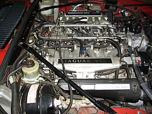

I use NGK BP6EF in ALL the HE engines. Gapped o 0.025" exactly.
NGK stopped making the Non Resistor version about 12 months ago, so, now I use BPR6EF, and Loctite Anti Seize smeared on the threads.
As for doing the job, Doug has it sorted, BUT, clean each plug area BEFORE removing that plug, and I mean CLEAN. Anything you miss will drop inside that cylinder, and ruin your day.
Remove the distributor cap, #3 on each side, and #4 on B side will have the tool actually in contact with the cap, and you will crack that cap in less than a heartbeat, and then utter odd words of satisfaction.
Alex (aka OB) also has sound advice.
A Sanden compact A/C compressor sorts the #1 plug issue 100%, coz then you can even "see" the plugs.
First time doing them, about 6 hours and 12 stubbies.
I do them now in less than an hour, BUT, my engine V is CLEAN.
![spark plugs-rh-general-engine-view.jpg](https://www.jaguarforums.com/forum/attachments/xjs-x27-32/215324d1527412301t-spark-plugs-rh-general-engine-view.jpg)
Have fun.
