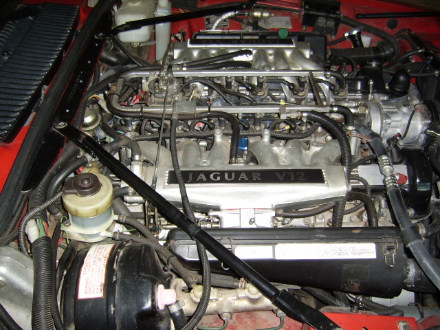

They are made from what we call "Bundy" tubing. Pretty easy to work with at produstion level, and definately NOT for looks.
Mine got the works when the engine out for refresh internally, and a lot of that pipe stuff dleted.
Manifolds got the heat proof Aluminium paint treatment, and name plaques.

You showed me yours so it's fair to show you mine .

Now that is snake pit (German name for the V12)...!

That is a beautiful engine bay!
