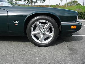

I have those Revolver wheels on my XJS. All you need is a 1/4" spacer at the front wheels and no spacers at the rear wheels. The tires are the Continental Extreme Contact DWS06, size 235/50R-17. Tight fit at full turns, but no trouble.
Attached Thumbnails Tempted by the xk8 wheels, will they fit?-cimg2231-reduced.jpg

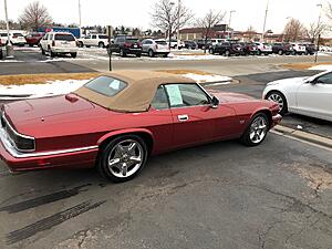

I have them too.

Originally Posted by Time-Pilot
I have them too.
The best looking wheels for an XJS
Is that your car, Time Pilot? (window sticker?) Well, my kitty has the same wheels and this is the first time that I see another XJS with chrome Revolvers. I believe that these are the best looking wheels for the XJS, especially the chrome ones. They truly enhance the car's appearance, I believe more than they do the original first generation XK8. Again, my taste.

Yes, that's from the day I bought it. The dealer took it in and was going to send it to auction since it was not something they would normally put in their inventory, they were a Cadillac dealer. I was driving by and saw it, drove it and it had a few issues with the ABS and brakes that they agreed to fix so I bought it.
