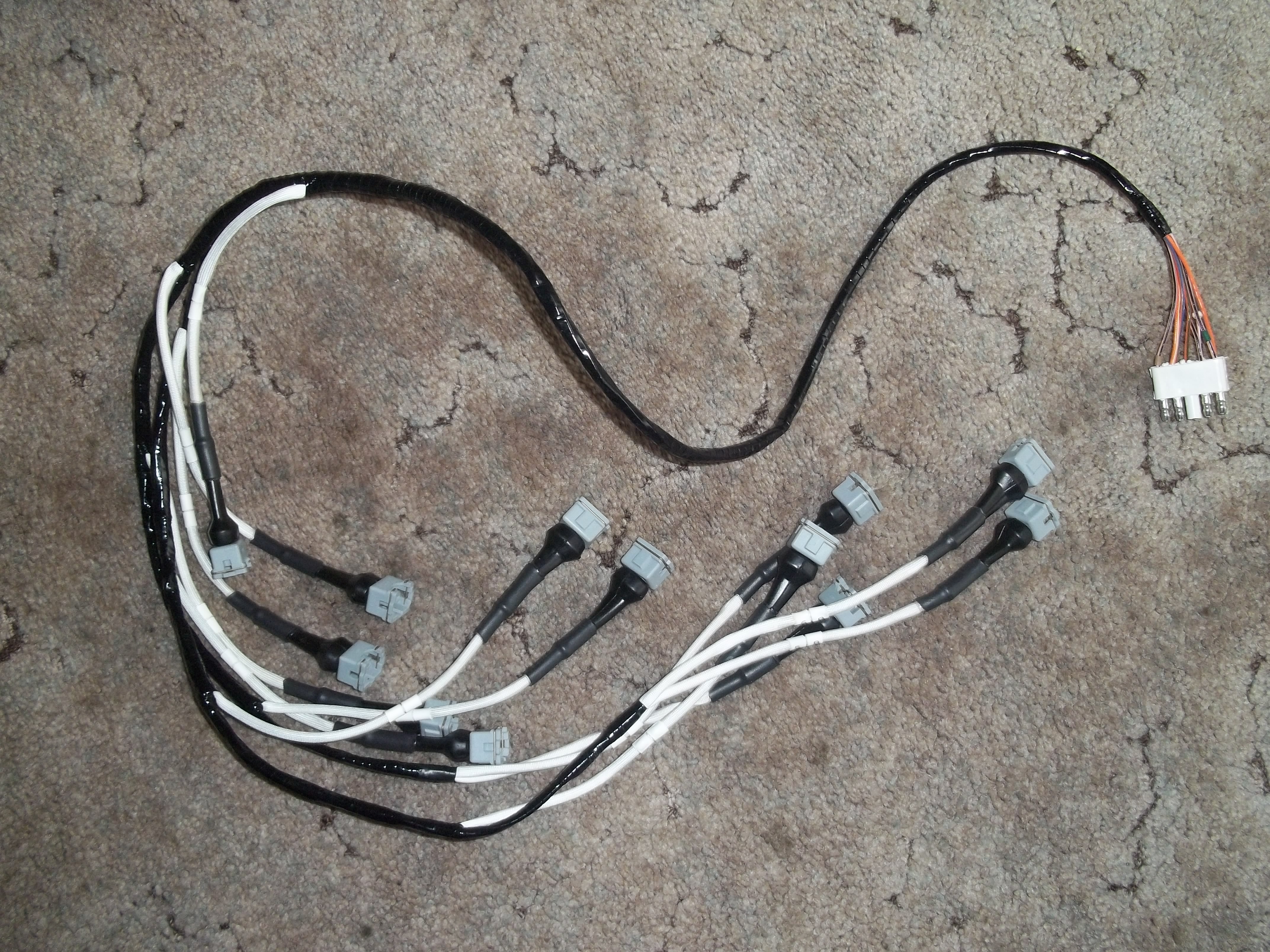

They just pull off while wiggling them. be a bit rough with them
Attached Thumbnails Is there any alternative to these Fuel Injection Clips?-100_1671.jpg
