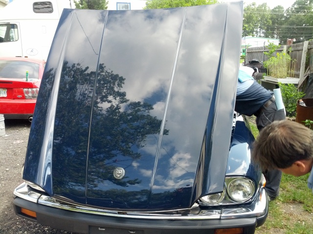

Got there and they were still removing some of the rubbing compound:

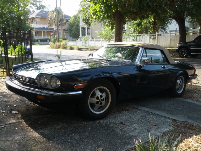

At home in the driveway:
The good:
The overall paint job is really quite good with a nice clearcoat all around. The old paint job was not nearly this good. Oscar (the owner) said to give it about 6 weeks and then have it buffed to make it sparkle more. Passes my '5 foot' test with ease. There are only a few imperfections on the entire car. To prove that I am an idiot, I did manage to already put a small chip in the area where the boot hits the body... the area will contact on my car if you don't shut it gently. Will have to watch that in the future and hopefully find some way to cushion it... but it sucks to start looking for touch-up paint already.
They also removed, sandblasted, and repainted the windshield washer cover. I wasn't really expecting that, and it was a nice touch as it was chipped up.
They fixed the weather seal on the driver's window that had popped out some at the top and was binding the window the last 1/5 of travel. I'd tried to fix it before myself without much luck... I hadn't mentioned this at all, but good to see someone was paying attention and corrected the issue (there's no reason this would have come out for the paint job so it couldn't have been fixed in the process).

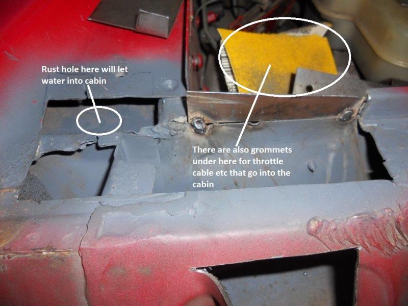

Going back to your earlier post about water getting into the cabin once the chrome trim was wetted.
I am not clear exactly which particular bit of chrome trim (out of all the lot around the screen) you mean, but I think you might be well advised to take off the chrome and see what is underneath it, if anything! I realise it is a pain now the paint job is done, but I feel you might find a huge rusty hole under there. If it is not treated and fixed, it will only get worse and worse.
If water is getting into the cabin, and not through the door seals or fan units, there is a hole, it could be just that the screen rubber to body join needs resealing, but sadly, it could mean the metal under the chrome surround has disappeared.
Just my thoughts...
