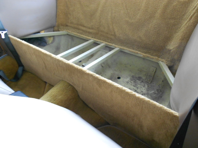

this helped some for front scuttle shake, not perfect but maybe with bottom crosses would improve twist of body front to rear on hard accell.
also pic of Aston Martin rear body stiffener bulkead, for prototype XJS-C.
back in the 70s Grp44 changed the whole rear cage setup, just to keep the car straight comin off the turns, said it was like a snake wiggling.
they found that with the XKE V12s, some bad comments about it!
