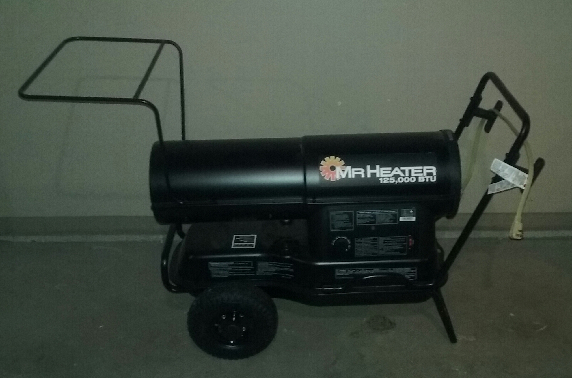

My hair dryer thawed the stubborn door lock.

You probably shouldn't admit that you have a hair drier.

I am just happy to have hair. :-)
