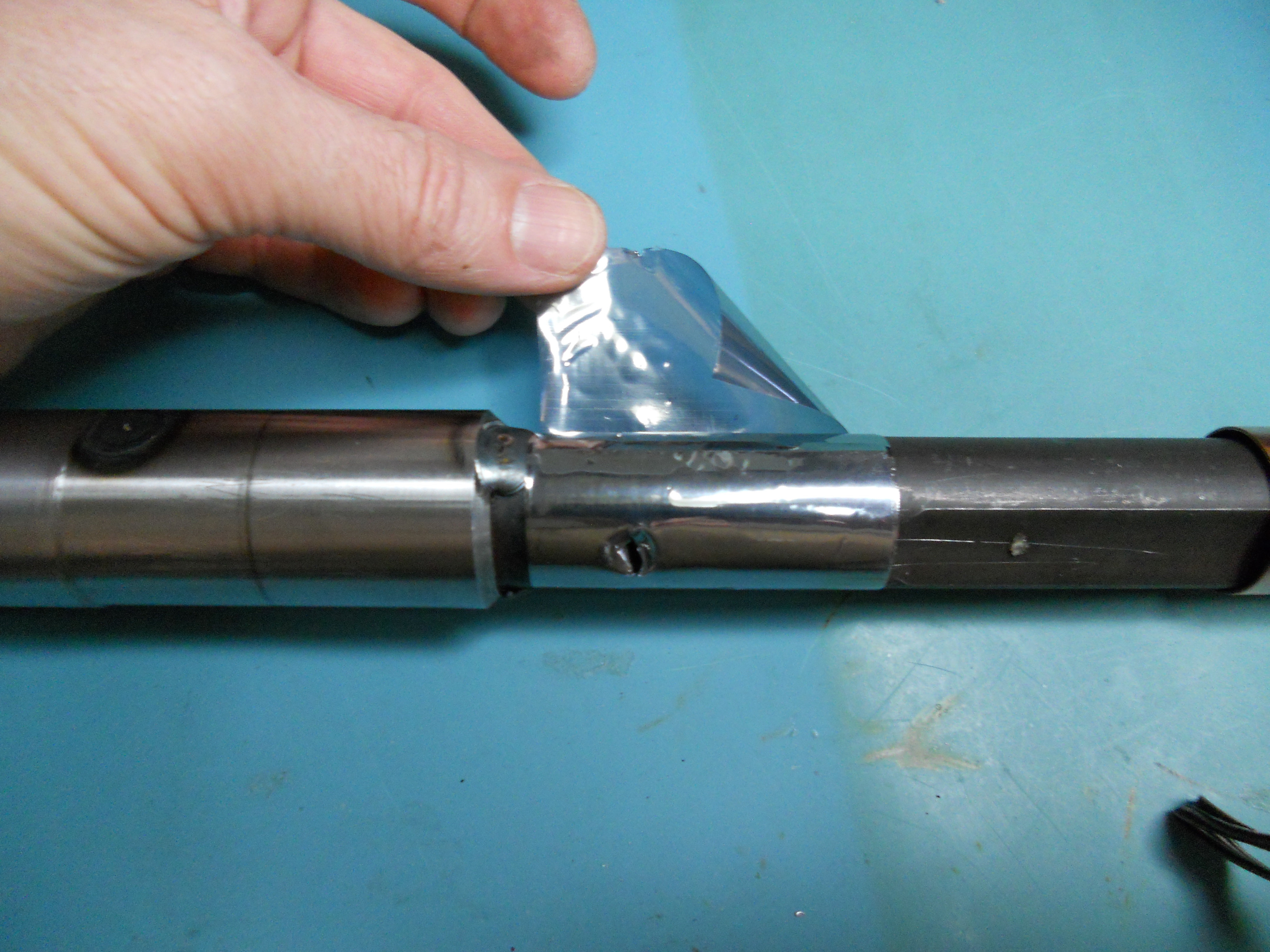

- fixed horn button on the steering wheel. The horn mechanism was shorted inside the column. PO simply cut wires and installed a button-switch (which I didn't like one bit). Ended up removing and taking apart upper column, now I understand why PO didn't fix it - it's quite a job... but now I am riding around happily honking at everything worth a honk :-)
Also cut off old stinky leather off the steering wheel and gave it a good bath with Clorox... it will do for now..
here is column taken apart:
I've been there. This is how I fixed mine.
The insulation is an old anti static bag from a PCB, these are made from mylar and are strong. The sleeve is a copper pipe joiner I machined out. The whole shebang is held on the inner column with heatshrink tube with adhesive inner.
