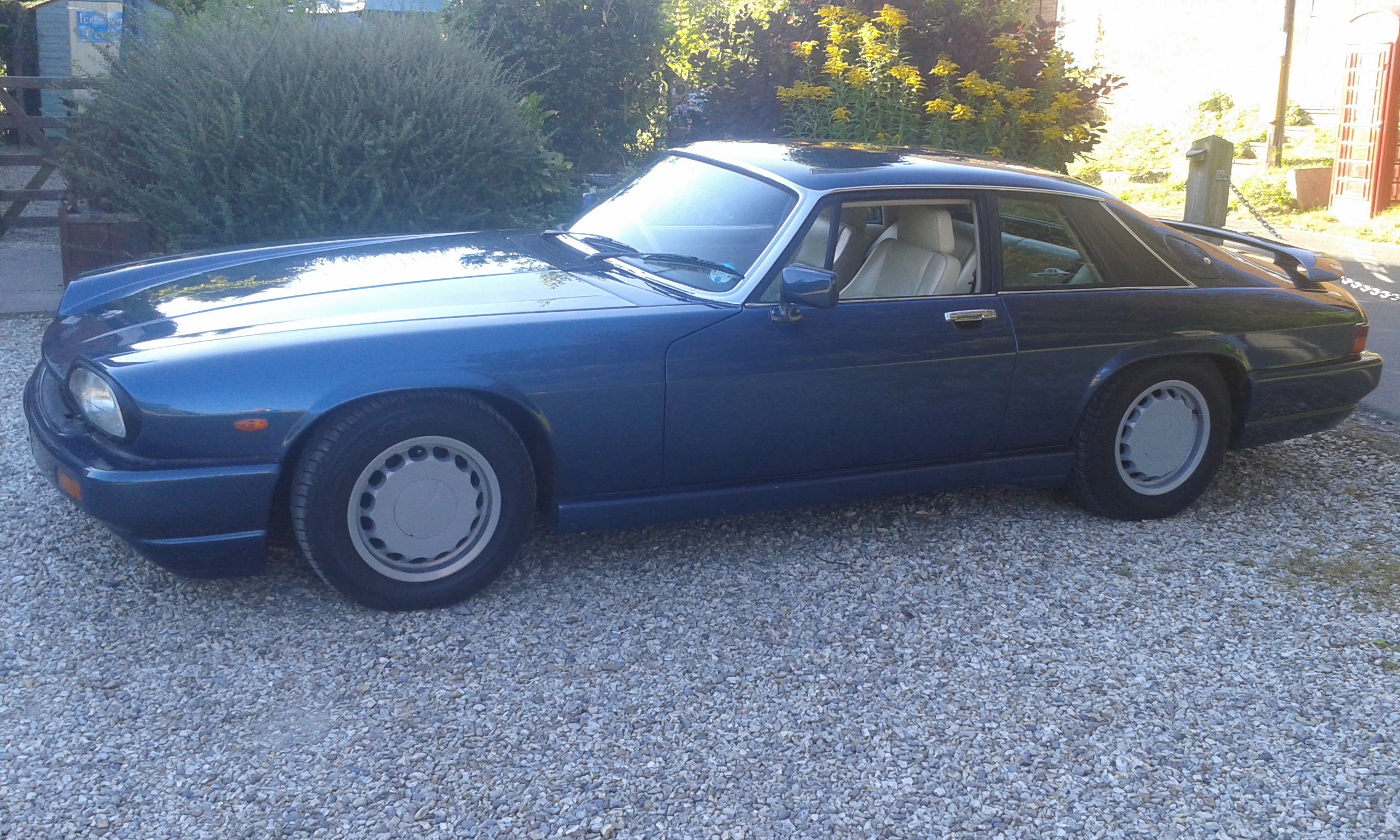

I've had an electric polisher in the garage for the last 3 years, still unopened.
Bought it for a previous XJS that turned out to be mechanically a very long way from washing never mind polishing.
She who must be obeyed is away for 36 hours so I decided to focus on my cars instead of hers for a change.
Broke it out of the box, removed detritus and dead things (one of which I am sure that I saw in an episode of Stargate), RTFM'd it, plugged it in and off we went.
Quite pleased with the result and the lack of aching fingers and sore back.
