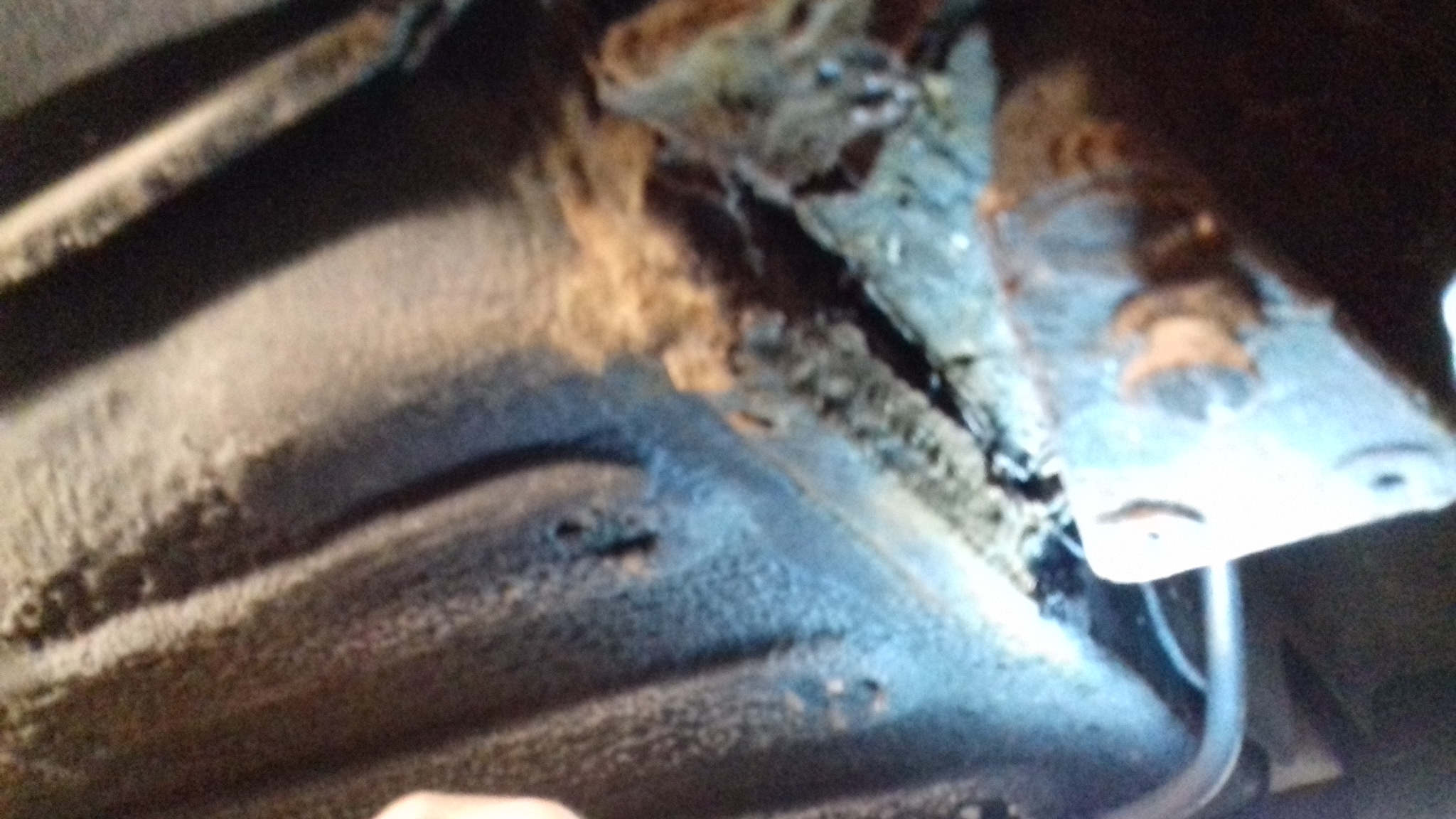

Come on Steve, where exactly (and I do not mean where did you lie down)?
Bought a trolley jack.
Jacked the car up.
Crawled under the car and had a lie down.
Released the trolley jack.
May as well, it's frigging killing me anyway!

Further to the question, back end of left side passenger floorpan, behind the seat.
There is a tube that runs through to take the hand brake cable from the lever through the rear bulkhead; depending on market one side or the other should be plugged.
Mine wasn't so over the years the rear wheel had been throwing water through the tube and the rot set in to such an extent that the jacking point got pushed up in to the floor.

Classic rust spot there, and just as likely to have rotted inside to the out. If you feel keen enough, remove the rear seat and you should find a hole in the outer lower corner of the vertical seat panel (the one just behind your shins if you were sitting in the back seat). Some cars have a rubbishy seat belt slider rod in this position. Anyway, get some AquaSteel and using a garden sprayer spray it in the cavity through this hole each side. Wait a day and do the same with an aerosol of wax (Bilt Hamber's Dynax S-50 seems to be the best I have found).
Just in case you get bored with driving it, something else to do.
