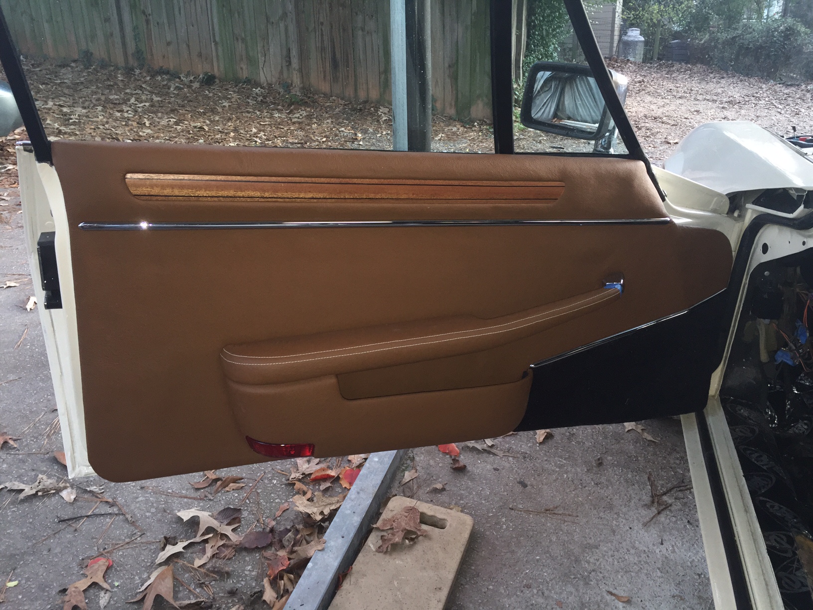

Originally Posted by bullittandy
The interior wood is 3M mahogany wood veneer with PSA (pressure sensitive adhesive). Peel and stick. So it's real wood and feels like that before finishing. I applied a spray polyurethane finish that's a satin finish and I deliberately didn't bury the wood in the finish so that the grain can be felt and seen through the wood.
If you wanted to change wood finish I would HIGHLY recommend using a vinyl wrap, it is so easy and the choices of wood grain are infinite. And the vinyl wouldn't feel like wood it would not feel like vinyl either-if you know what I mean.
You probably wouldn't even need to remove the wood to apply vinyl.
But, if you really wanted to change wood color with real wood then definitely get the veneer with PSA, almost as easy as vinyl and also has endless varieties.
Thanks for the info, Andy. One more quick question- when I do get to this step, do you suggest vinyl over a PSA Veneer solely because of the ease of application, or is there another reason behind it? I'm willing to take the time to do it right, and I love the thought of real wood on the ski slope, even if it is just a veneer. The prices I'm finding for veneers, though, are pretty expensive and I'm guessing vinyl would be cheaper by far.
Where did you get yours from, if you don't mind me asking? I'm sure you did your research and got the best!
I think I goggled PSA veneer, don't recall the specific website but I recall them being mostly similar. I think I bought a 4'x8' sheet and it was about $125. If you were clever with measuring and cutting I think you could make a 2'x8' sheet work. But I'd rather waste money on extra material so i don't have to wait if i make a mistake.
The vinyl is more forgiving and easier to apply, along with requiring no finishing. But, if you care about real wood then then you'd likely never be satisfied with a vinyl wrap.
For example, on the door panels I included two strips of black wood to add an effect similar to the original door wood. After I took the time to cut the wood and match the edges and glue it down I realized that I may have well as drawn two black lines with a Sharpie. Except! I woulda always known it wasn't real.
