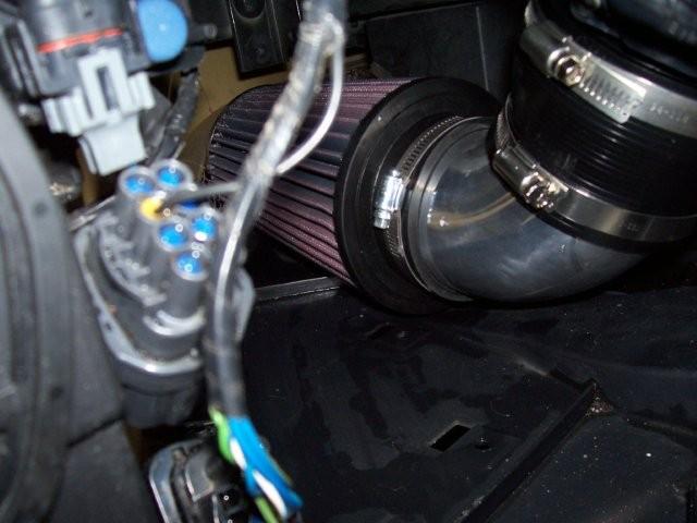

As a side note something that does not seem to have come up but appears (at least in the suspect advertisements) to be a good bang for the buck is the K&N air filter. Seems I have seen something like 8 Hp gain as a selling point.
I have had the front end off of my car and am amaazed that the thing can really breath at all. A guy on another forum removed all of the offending airbox and snorkle (his was an XK BTW without the dual airbox) and put in a conical airfilter where the airbox used to reside. No confirmed benefits though other than seat of pants. I would be really surprised after fooling with this intake system myself and seeing all of the hijinks (bends, kinks, and just overall length which I bet is at least 5 or 6 feet) that there isn't something (maybe alot) to be gained in the whole affair...especially on something like a supercharged car that is stuffing so much air into the engine...

Are you concerned about water intrusion thru the front (lower) grille since the filter sits so low?? It looks like rain water splashing from a car in front of you will kick up enough H2O to cause issues. Has this been an issue or are you just driving it on dry days?
