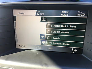

Originally Posted by jahummer
Looks like the colour scheme is updated too, with all blue. Any other "new" features added? Also the US does not have TV or DAB so any potential compatibility issues?

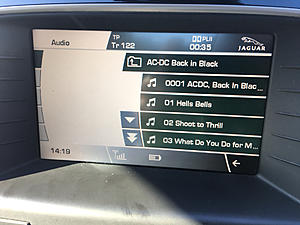

Well SDARS/Sirius and HD-Radio retrofit is also possible. With the later software you also have the possibility to retrofit the Portable Audio Interface which gives you USB and iPod connectivity that is fully controlled via the touchscreen, these were first introduced in the 2009MY. But it would appear that the Audio Head Unit would also need a software update in 2008MY or earlier cars for that to work.
I have Sirius but do not have HD radio - is this also a module or is it strictly software? Also have the ACM iPod/USB kit already installed, basically the same limited functionality as the one I installed in the Daimler SuperV8, how does it differ from the one standard from MY2009 and on? If it is full Apple/ipod integration with meta tags that may be of equal or even more interest than a camera.

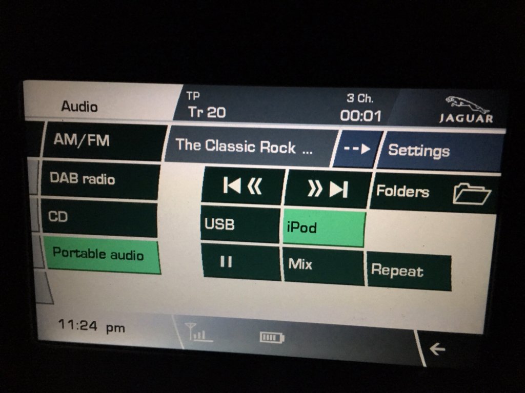

HD-Radio is an additional module, also some additional wiring (the AM/FM antennas run through the HD-Radio module, and then on to the head unit).
The Portable Audio gives you full control over the iPod/Phone, as well as the USB stick. I use the USB stick more, the folders on the stick are all named on the screen, the tracks are all named & numbered, it's miles ahead of the old ACM in the early X150's and the ACM in the X350, S-Type, etc...
I'll try to get some more photo's of the Portable Audio in action next time i'm in the car...
The components for the Portable Audio system aren't that cheap though, even 2nd hand, but they can be pulled out of an XF.

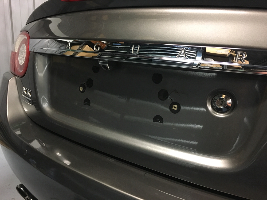

This mod is fighting me right to the very end...

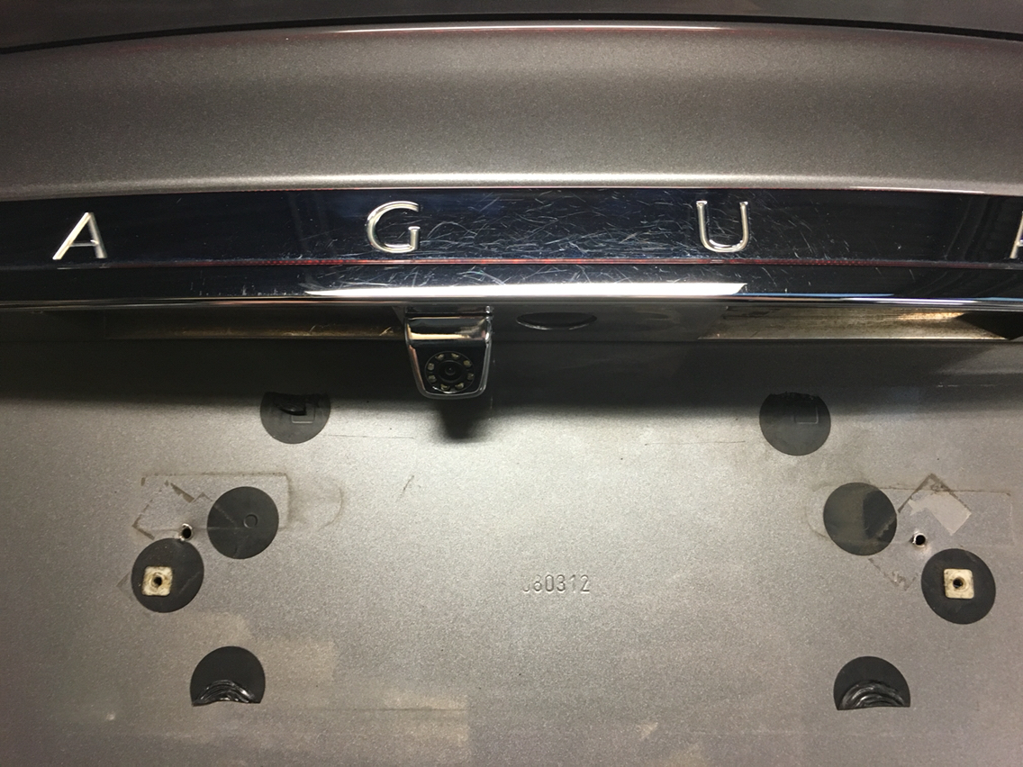

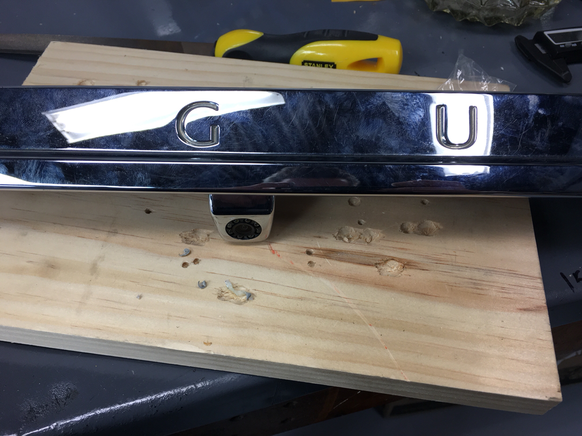

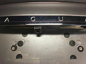

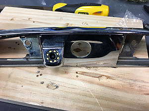

Today I worked on the car to finish off the installation of the camera to the boot lid and get the wiring in properly.
However it's not finished yet, I need a different type of camera. I'll explain why later, but here's what it looks like;
You see how this camera has a ring of LEDs around it, that's the issue.
When I ordered the camera from China, the picture in the listing showed one without LEDs, and this is what we need.
Why?
Because the camera does not give a video output unless the LEDs are lit up. There is a separate 12V supply for the LEDs, but that obviously powers the camera too.
The way that the factory camera works, well actually how the camera function in the touchscreen works, is that the picture stays up on the screen even when you shift from reverse to drive, and it goes away once you are over a certain speed.
This means you can't use the reverse light as a power source for the camera, because once you shift out of reverse, the camera turns off, and you're left with a blue screen.
The camera needs an ignition-switched 12V supply. But if you wire it up this way, the LEDs on the camera are permanently lit...
So I'm waiting on another camera to come from China now, this one I'm certain does not have LEDs, since many of the buyers posted pictures of the camera they received as part of their feedback for the seller.
Will be a couple more weeks until I get this finished now... 🙄
