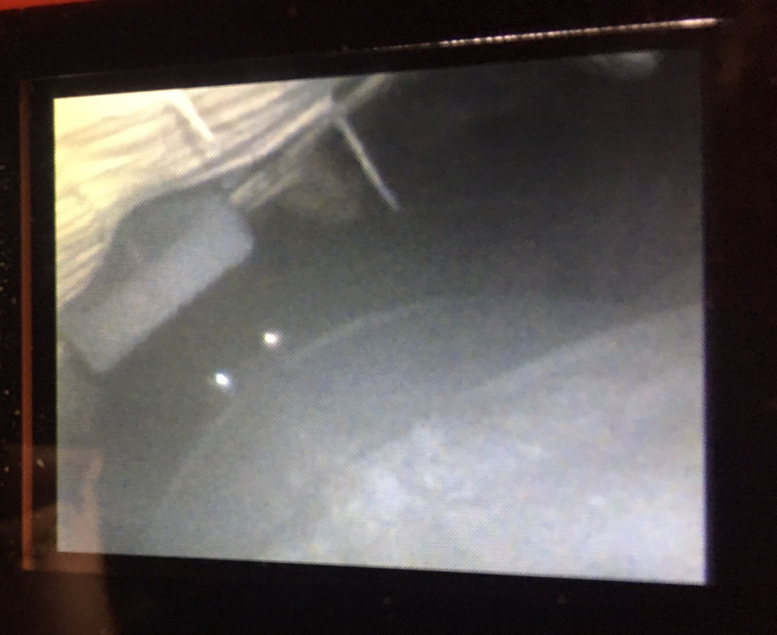

Here's some borescope pics of the duckbill on a 2007 XK
A/C drain duck bill fix - my solution-duckbill1.jpg
A/C drain duck bill fix - my solution-duckbill2.jpg
A/C drain duck bill fix - my solution-duckbill3.jpg
This is gonna be lots of fun on a supercharged car...

Even with the gearbox released off its rear mount it is still virtually impossible to get to

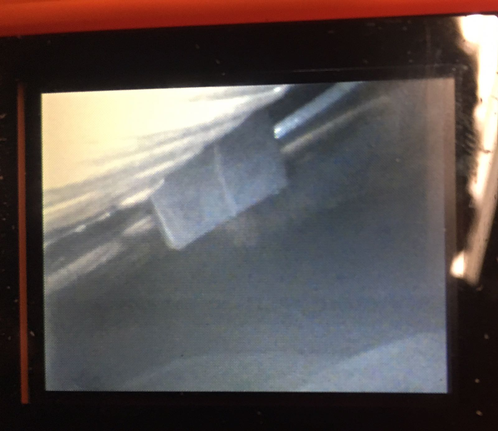

I was able to get a photo with a scope of what I believe
is the duck bill drain from the AC system.
It is in the location mentioned by by others top center of the transmission.
Was expecting it to be recessed. Based on descriptions.
However, it appears to extend out from face of the tunnel over the transmission..
Can someone confirm that this is the the AV
drain?
thanks
Aonsaithya (05-27-2018)
  #115
Old 05-26-2018, 10:50 PM
S-Typer's Avatar
Join Date: Nov 2010
Location: South Florida
Posts: 223
Received 65 Likes on 39 Posts
Yes thats the famous duck bill drain. I was able to get some Teflon spray lube on my finger and smear it around the inside. It helped greatly.
I found it the same way.. you can verify by running the A/C and looking for the drip on camera.
Joe
