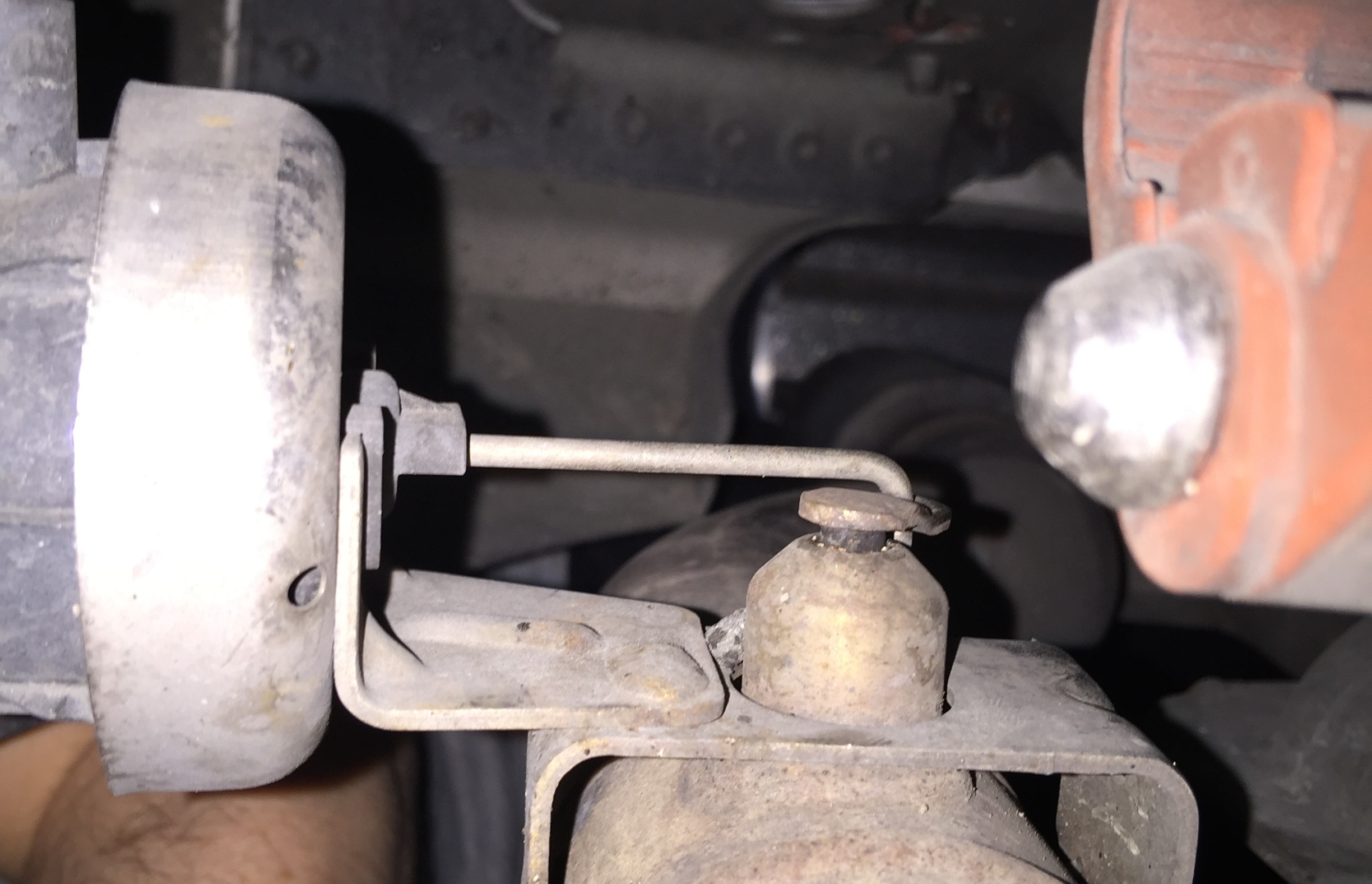

Drop the rear muffler disconnect the exhaust valve and permanently shut it by tying it off with wire

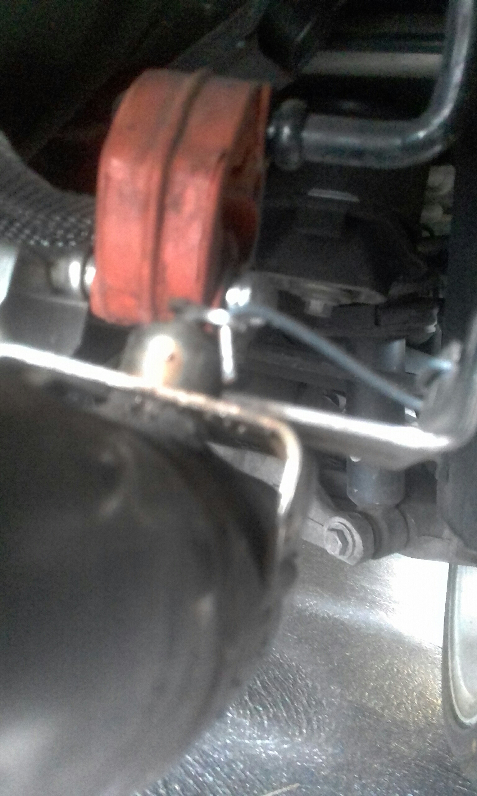

Thanks. That actually took less time than expected. I had a quick play while waiting for Xmas lunch to be cooked and, once I had sussed it out, the second side only took a couple of minutes and I didn't need to jack the car up to do it. The rod from the valve can just be pushed up and out then the valve arm can be rotated and wired shut.
The bad news is that the sound isn't very pleasant so I am going to have to sort something else out. Trying to get a decent sound looks like it is going to be a real case of trial and error.
It doesn't sound too bad in the video but at what I guess is around 3,000 rpm's the exhaust note is quite tinny and fluttery with a bit of a rasp:
