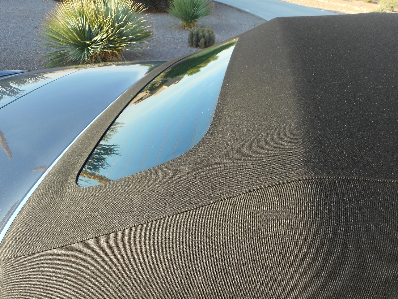

Attached Thumbnails Dying a Convertible Top-dscn3269.jpg   Dying a Convertible Top-dscn3270.jpg   Dying a Convertible Top-dscn3271.jpg   Dying a Convertible Top-dscn3274.jpg   Dying a Convertible Top-dscn3275.jpg
Dying a Convertible Top-dscn3276.jpg   Dying a Convertible Top-dscn3277.jpg   Dying a Convertible Top-dscn3278.jpg

The reason I use the "paint brush" method is to get full penetration into the fabric grain of the top.
If you look closely at the top fabric, there are micro indentations in the fabric.
With the brush, no over spray, no wasted product due to the product blowing away even in a slight breeze and you will use just less than a full bottle.
I suggest the top be reconditioned in a garage then moved outside once completed.
Total cost about $17.00 to protect and bring the top back to a "like new" condition.
This should be done about every 9 months to one year.
