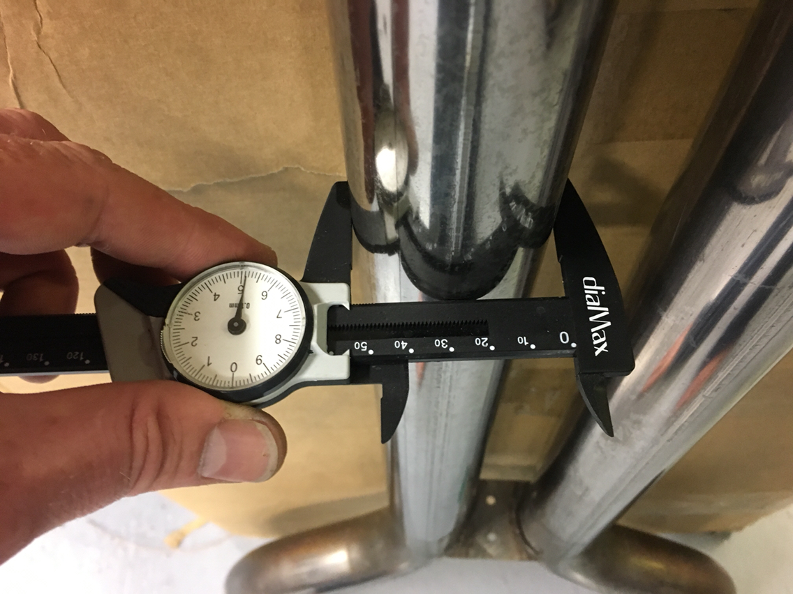

The XKR-S/PAE centre pipe has the same 55mm OD tubes as the regular XKR, and the same as the 4.2 as well.
There is zero drone on my XKR, none whatsoever. 400 cell cats, straight pipes with x-pipe, stock rear muffler, and the active exhaust still functional.

I was told that the 4.2's had 2.25" pipes and the 5.0's has 2.50" pipes. did they not step the 5.0's up to 2.50"? glad I didn't order this yet. they make it in a 2.25" as well....

Well it's 55mm OD which is close enough to 2.25", I measured the OD at several points on the 5.0L PAE/XKR-S pipes and it's the same all over.
The tailpipes, coming out of the rear muffler to the tips are bigger, but not the centre pipes.
