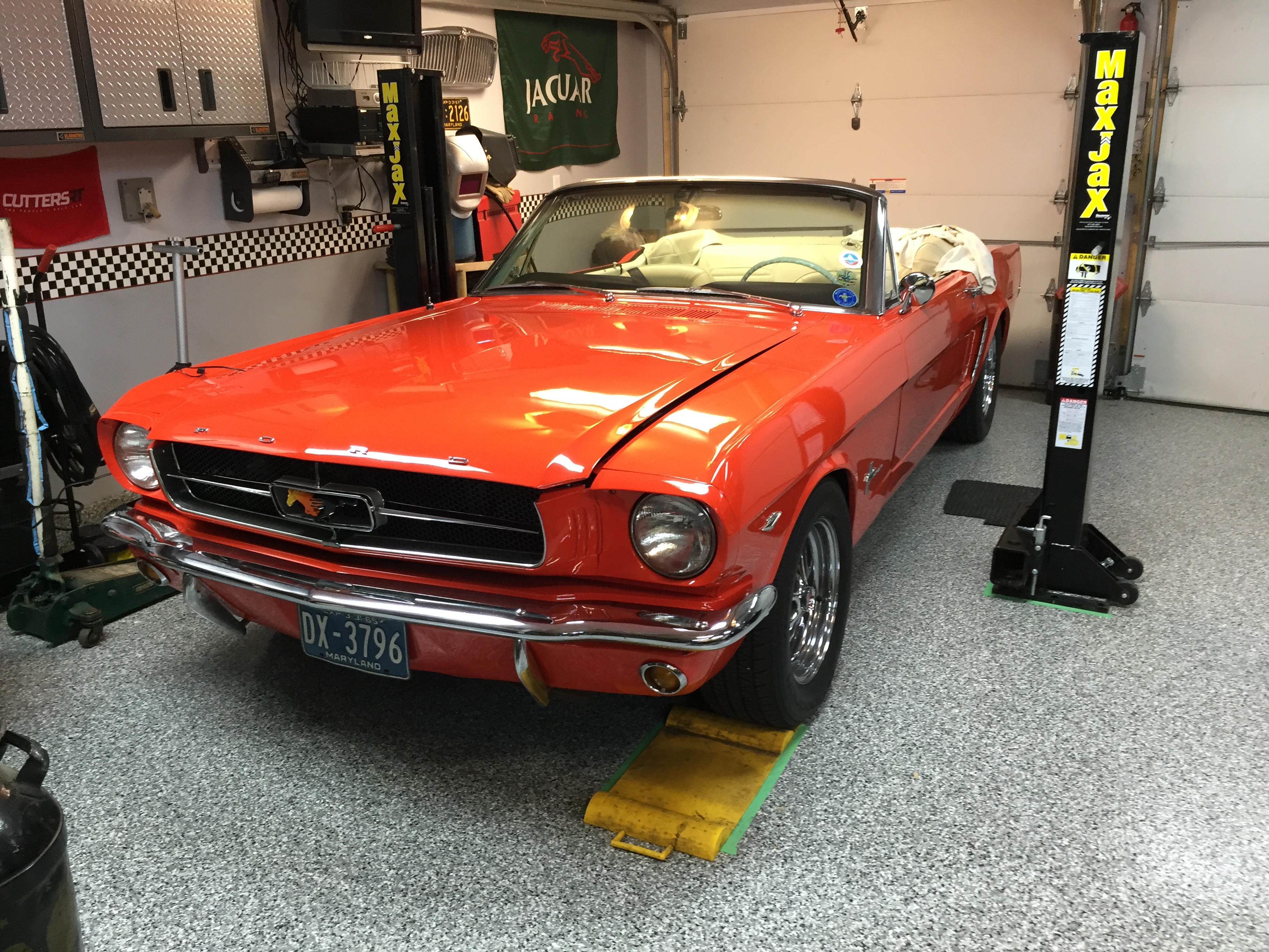

Default nuts and screws disappear
I love my professional applied coating, however, when minor screws bolts washers fall on it.....they disappear!
I had the crew add a slight texture to the finish to make it less slippery.

Ken,
That looks great! How long ago was it done and what was the cost? Any issues with tire rubber sticking to it or being slippery when wet? What shape was your concrete floor in before, and what did they do to prep it? How long did it take from start of prep to completion? How do you keep it so clean? Thanks,

Yeah Stuart, it's a great finish. I had it installed in the summer of 2014, as I recall, the number was around $2200-$2300. It's the new polyurea finish. In this case the floor was 3 months old. Nothing sticks, nothing peels, it's very durable. Any oils, wipe up easily.
The really cool thing, is they coated the 5.5" baseboards with the same material which creates a waterproof area. This was part of a 400 sq.ft. expansion I did at the time.
They first etched the floor with a cement sanding tool before adding the coating. The second best part...... I could walk on it 8 hours later and drive on the next day. But, as I mentioned littl bits just disappear.

Absolutely for a working shop, leave those "flakes" in the bag. You want a solid light color like grey or beige so that when you drop a tiny tool or fastener, that you can see it. I've seen sand added for traction, but I wouldn't want to have those sharp grains in case I trip and fall, which I've done in the shop. A bruise is enough without also ripping my skin off. I'd ask the installer about a less aggressive additive.

Phil, only had I known regarding those flakes and how they seem to "swallow" those little bits. I may have made a more informed choice. But, I do like the "flakie" look.
So, I'll pass on to those thinking of this finish, you've been warned LOL!
