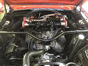

So, is that going for a custom re-do? That would look neat on my mustang...
