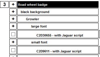

It is one of these but I am not sure which.

It is an old design. The P/N for that colour and style (black background, small font with Jaguar script) is C2D9611
Beware that many aftermarket suppliers of Chinese copies also use the Jaguar P/N for identification so it is no guarantee of originality. As I recall the OE ones are manufactured in Italy for Jaguar.
One source of the genuine article is forum member GrowlerJaguarParts (Kevan Hughes) in the UK. Big discount on manufacturer's price so it could be worth the shipping cost.
GROWLER PARTS - XK8 & XK
For clarity, I will add that I have absolutely no connection with Growler Parts other than as a satisifed customer. I've had a few sets of wheel centres from Kevan and he supplied me with a set of the current red style for my XK last year.
