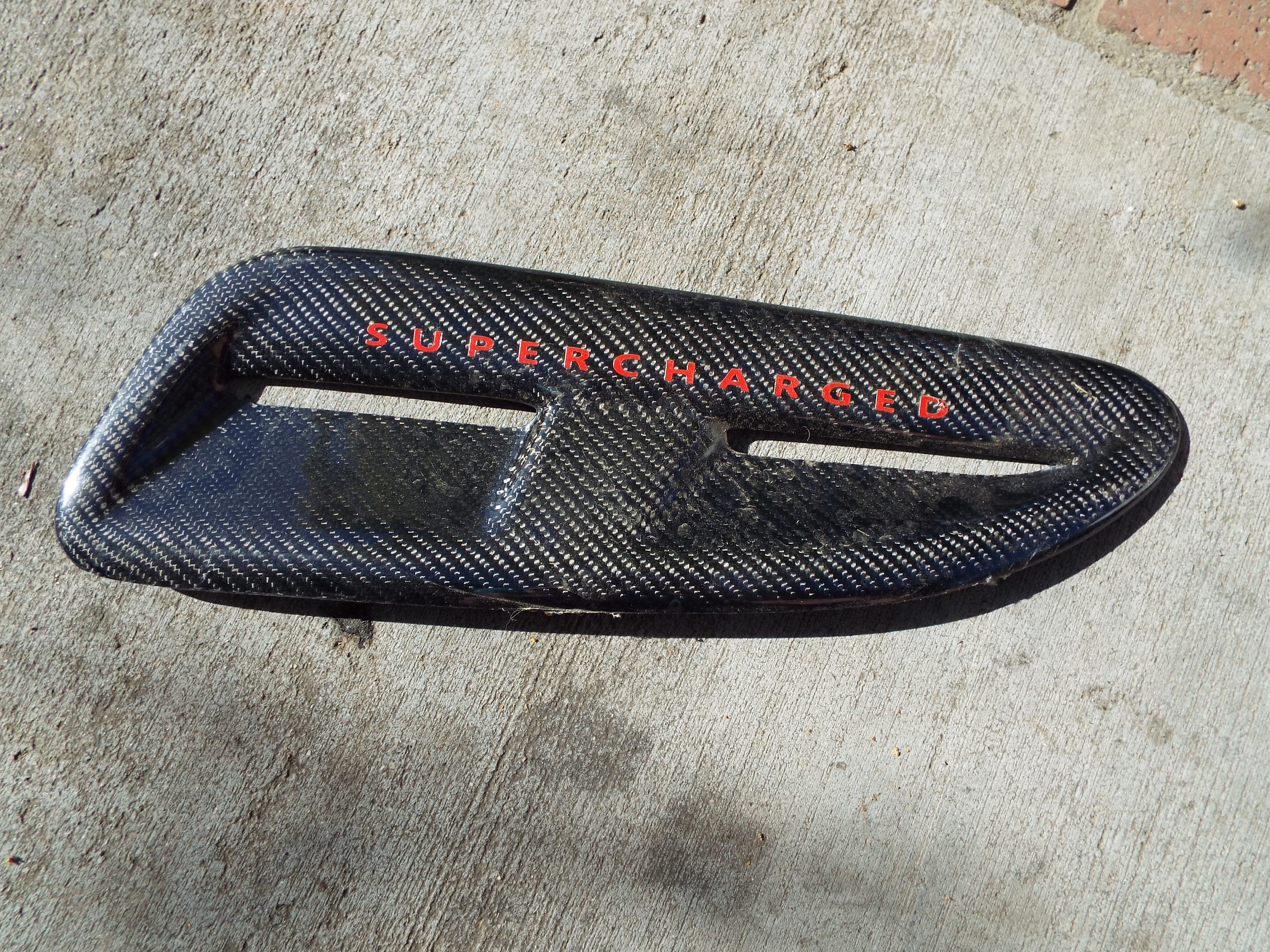

Be careful with the hood louvres. I ordered a set from someone on ebay who decided against using them, one fit well and the other not so well. But they don't have clips like the originals, so you are asked to use automotive tape to hold them in place. I used heavy duty 3m automotive tape, and I drove less than one block before the one that actually fit better flew off and into traffic, never to be seen again. I didn't even have them for 5 minutes before they were rendered useless. Needless to say, I'm back to my painted, black ones.

The clips are reusable, but the carbon fibre replacements don't have the tabs that protrude out of the bottom through the hood to receive the clips. I will take pictures of both tomorrow and post.

Sorry it took a couple of days to get the pictures. First you will see the carbon fiber replacement, the back, front, and side view. This is supposed to be attached to the 1/2" lip of the hood surround with automotive double sided tape. As I said in a previous post, mine lasted exactly 1 block before it flew off. The second pictures are closeups of the tabs from the original vents that poke through the hood and receive a clip that keeps them anchored. (sorry about the blurred picture of the clip)

Do all the hood louvers come with red font "SUPERCHARGED"???
I hope mine comes that way... I have a red badge, wheel caps and seats on a black dynamic black pack.

I had the Mina cf vents, like tberg's above. They feel very flimsy because they are very thin, but they are pretty enough and do the job. I didnt have any problem with them.
