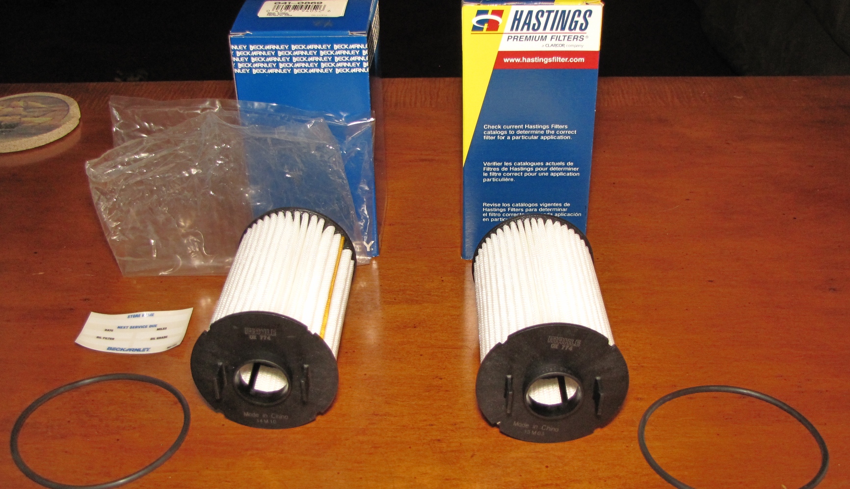

I can't confirm if B-A is Jags OEM, but Beck Arnley is at the top of my list so far. Compared to Wix and Hasting (Actually Hastings is identical to B-A only with cheaper packaging.)
Doubt I'll ever pay Jaguars price on an OEM for comparison, but any of you do it your-selfers that do buy OEM might take a quick comparison to this image for markings and such. Would be interesting to know...

B-A does not make parts, they rebrand parts. Also notice the pleat count in your pic is greater in the Hastings. (more media) Mann and Mahle are the general providers for filters to Jaguar.

Good to know, thanks!
They will be my next 2500k mile purchase.
I plan to walk thorough each brand for comparisons. Kinda a poor mans evaluation, I know, but these things always have me curious. At present, I keep the "winner" (subjective of course) new in the box to compare to my next order. The looser goes on the car for 2500K miles, and I buy the next brand.
To reiterate, I am not equipped to do a scientific eval of products, but I like to view my options from a common sense point of view.
So far, I'm on to my third name brand, and havin' fun with taking a look at them.
Mann or Mahle are my next obvious choice, so again thanks!

This may be a little off-topic, but the big thing to keep in mind when it comes to spin-on oil filters, is not just the filter media, but the bypass. Jaguar spec is 1 bar (14 psi) differential, and many cheaper filters can bypass oil with as little 6~8 psi differential. Many do not understand that if you use a filter with a poorly designed bypass, you can actually starve the engine for oil. This is why the trend has been to return to a cartridge style filter, with the bypass part of the housing itself. That way, the manufacturer can assure the proper design, and bypass flow.

Box.... The 5.0l filter is a top mount cylinder, no bypass built into the filter itself. Lack of media particulate testing is why I consider my comparisons subjective.

I'm aware that the 5L is a cartridge style. Also be mindful though, some oil will bypass the filter media when the pressure differential is above 1 bar of pressure. It's just the way it works. As far as filtering capability, you won't find a cartridge that will trap particulates smaller than about 20 microns. Soot and ash as well as smaller dirt will certainly pass-through any filter.
For the 5L, change oil at regular intervals about half of the extended life interval, and use either the Castrol Pro E w/FST or the Kendall GT-1 w/Liquid Titanium, (both of these are proven to reduce wear and is the exact same additive package) or an additive like BG's MOA.
