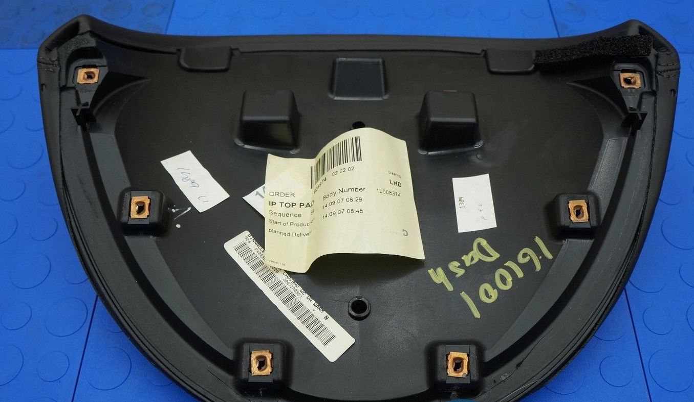

I should say possible experiment. I like the concept of a heads up display and there are a lot of aftermarket ones available.
Issue for me is that they are a bit bulky and cheesy sitting on the dash of any car. So what if you could conceal it?
The question is for those who've removed enough of the dash to spare me the work. See the attached. With this gauge hump (I'm guessing there's a real name for it) removed, how much room is behind the gauge cluster, if any and in the second pic, from the large piece of paper, that says "body number" on it - downward ( the lower slope that flows to the windscreen), what if anything fills that void?
My thought is to install a HUD within the gauge hump with a cover that matches the dash to slide under the hump and expose the HUD.
Much to think about for me as to whether I want to take this on but I know a lot of you have removed or had your dash removed and others removed the gauge cluster, so first things first, how much room would you speculate from memory is in there?
Thanks in advance.

^^^^ That may be a good idea! . . I'd also run a switch concealed somewhere to turn it off under some situations.

The cluster for the most part, it (the cluster) is not that hard to remove if you want to see for your self. Guess it would also depend on how much room the HUD needs. Interesting idea though.

The actual units are fairly tiny and should be a fairly simple install. I'd personally buy a new/used/salvage dash part to cut up and fit the unit, saving the original for whatever reason.

giving it a little more thought, these are designed to lay flat on the dash. I'm going to have to write a few manufacturers and see
A: how far away from the windshield will still enable s clear projection
B: must it lay flat to prevent distortion?

If you use, or install a HUD with a regular standard windshield there is a strong possibility the display in the windshield will be dim and distorted (double or blurred).
Before going through all the work, buying parts and making modifications to your Jaguar, I suspect it would be wise to consult a windshield expert. There are lots of related articles about HUD and having a broken or damaged windshield and replacing it with a regular standard glass windshield.
A proper HUD windshield will cost up to $200 more to replace vs standard glass. Be sure to complete your due diligence before proceeding on the modification.
Thank you for the heads up and the advice Richard. That's a new one for me, but I've just begun reading up on the HUDs. Initially focusing on fitment and readouts. If I were to undertake the project, I have to be able to customize the screen as they typically have multiple screens, each with it's own set of features. I will have it recessed and given our dash layout, switching screens would need to be remote or customizable. Nothing I've seen thus far even remotely addresses these issues so I may never get to the windscreen.

I had a loaner car a few months ago with a factory HUD and the windshield indeed was unique in the area where the image was reflected, providing optimal brightness and contrast. You could tell because as soon as you moved off axis from the treated spot on the windshield, the display immediately looked the way a regular dash reflection appears, washed out and faint.
EDIT: Don't most of the kits come with a bit on tinted material to placed on the inside of the windshield?
Yes they do and there are high quality versions and low quality. The good news is they're sold as a standalone product too.
I've watched a multitude of videos. Most are poor in the daylight but it has a great deal to do with the quality of the plastic masted to the windshield, in addition to the brightness that the unit give off. They have to reach a balance. Too bright at night is a distraction. Some advertise auto dimming at night but the daytime is still too poor.
So far, I don't like what I'm seeing on the market. Having so many screens in these units that you have to scroll will not work for our purposes. None appear to be customizable. The unit is out of reach and would be recessed. I need one or two screens and will have to find a way to toggle them as Stuart suggests. I came across one that had OBD2 and GPS (two displays but I can't find it again.)

I just ordered a gauge hump & will modify it for the HUD unit. It will probably take me a few weeks to get the project going as i'm in the process of moving. I'll post some pics when I'm finished.
