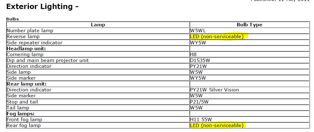

Old 12-27-2017, 04:00 PM
u102768's Avatar
Join Date: Jan 2010
Location: New Zealand
Posts: 2,941
Received 1,490 Likes on 908 Posts
They are LED's even on the 4.2 litres.
Sean W (12-27-2017)
Old 12-27-2017, 04:23 PM
Sean W's Avatar
Join Date: Jun 2013
Location: USA
Posts: 8,401
Received 4,256 Likes on 2,379 Posts
I'll be dipped. I thought there were a few internal LED bulbs but duh. It's staring right at me in the wiring diagram. When in doubt, read the manual I guess. Think before you type Sean. Geez. Thanks guys.
