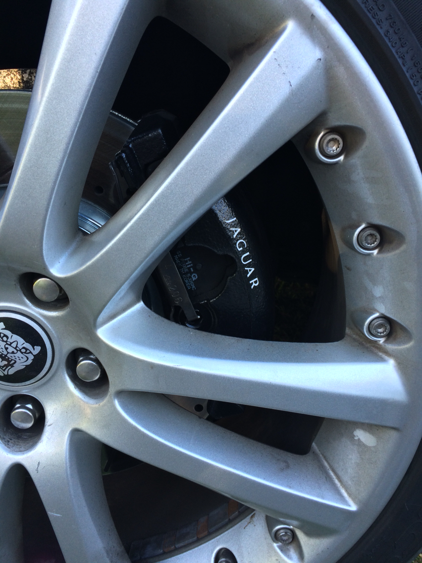

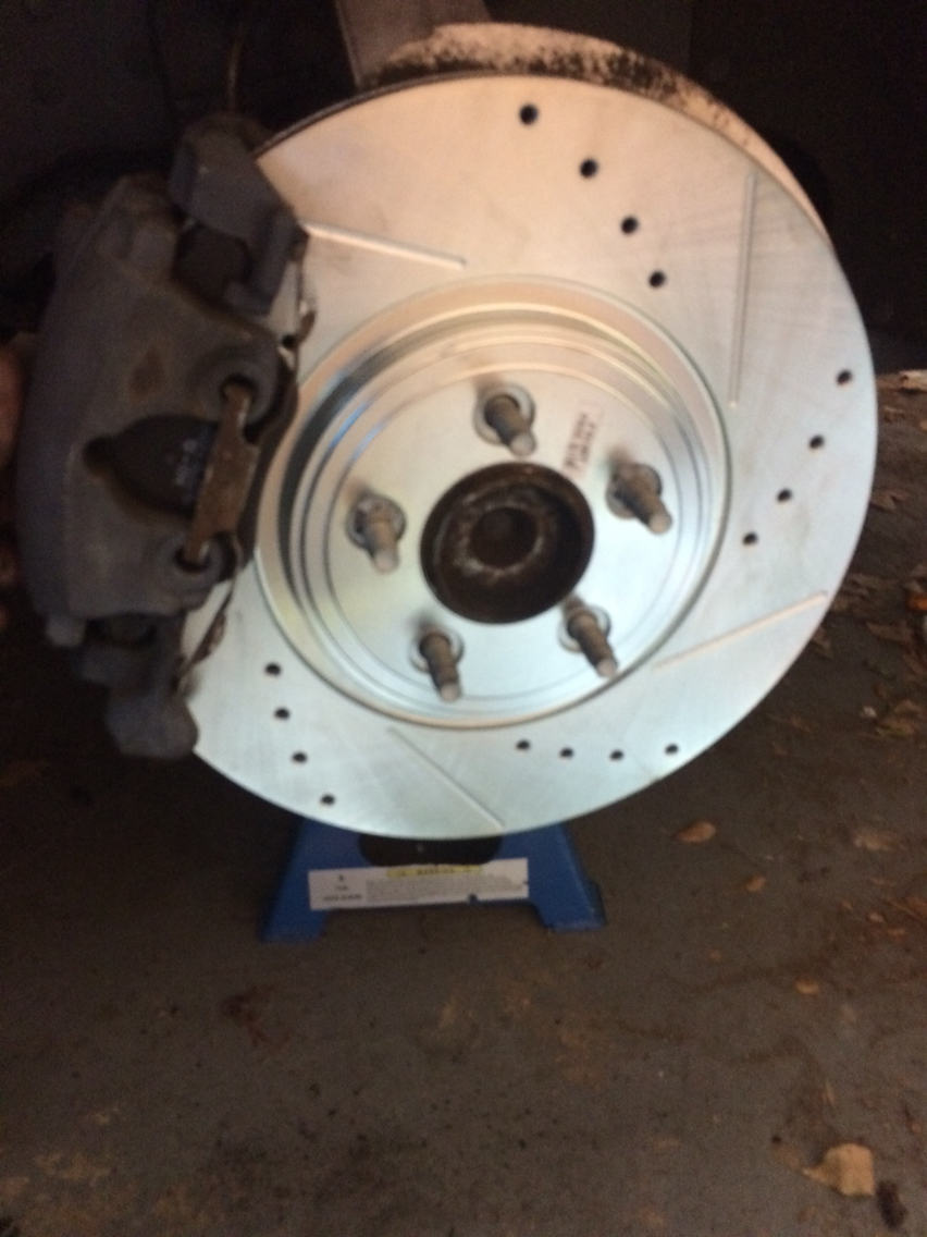

I just did the lot of my Cat including front pads , rotors with rebuilt calipers due to a sticking piston
The rear got pads and rotors
Attached Thumbnails Replaced all pads Easy procedure but soft pedal after-photo207.jpg   Replaced all pads Easy procedure but soft pedal after-photo173.jpg   Replaced all pads Easy procedure but soft pedal after-photo630.jpg   Replaced all pads Easy procedure but soft pedal after-photo230.jpg

Likes: 35
Looks good, Steve.
On the rears, did you just pull the battery and allow the system to reset the handbrake itself, or did you use the SDD/Mongoose tool ?
I can't get Mongoose to work so will likely go the battery/reset route myself

steve_k_xk's Avatar
Joined: Jun 2015
Posts: 2,916
Likes: 1,560
From: Sydney, Australia
No need to pull the battery as the vehicle doesn't automatically engage the electronic handbrake unlike the Citroen I just did recently
Make sure you have a calliper wind back kit handy and after every pad change I apply the brake pedal then move over to the other side
