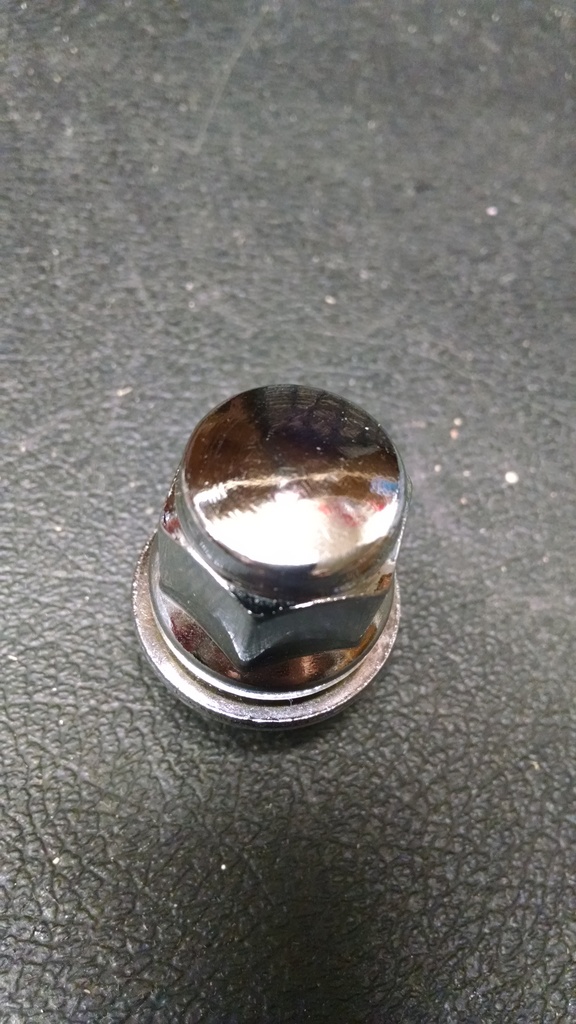

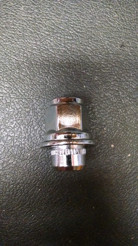

Ok. The washer is captive and the depth from the bottom of washer to end if shank is 12mm. Here are some pics of the finish. Looks ok but not the best. Gonna get coated with brake dust anyways . Also I don't know if I have Nevis wheels as I'm still a Jaguar novice but here's a pic of my filthy wheel with the lugs installed . Hope this helps.

Yeah, I THINK yours are the Vulcan wheels.
Thanks for checking, I'll order a set.
