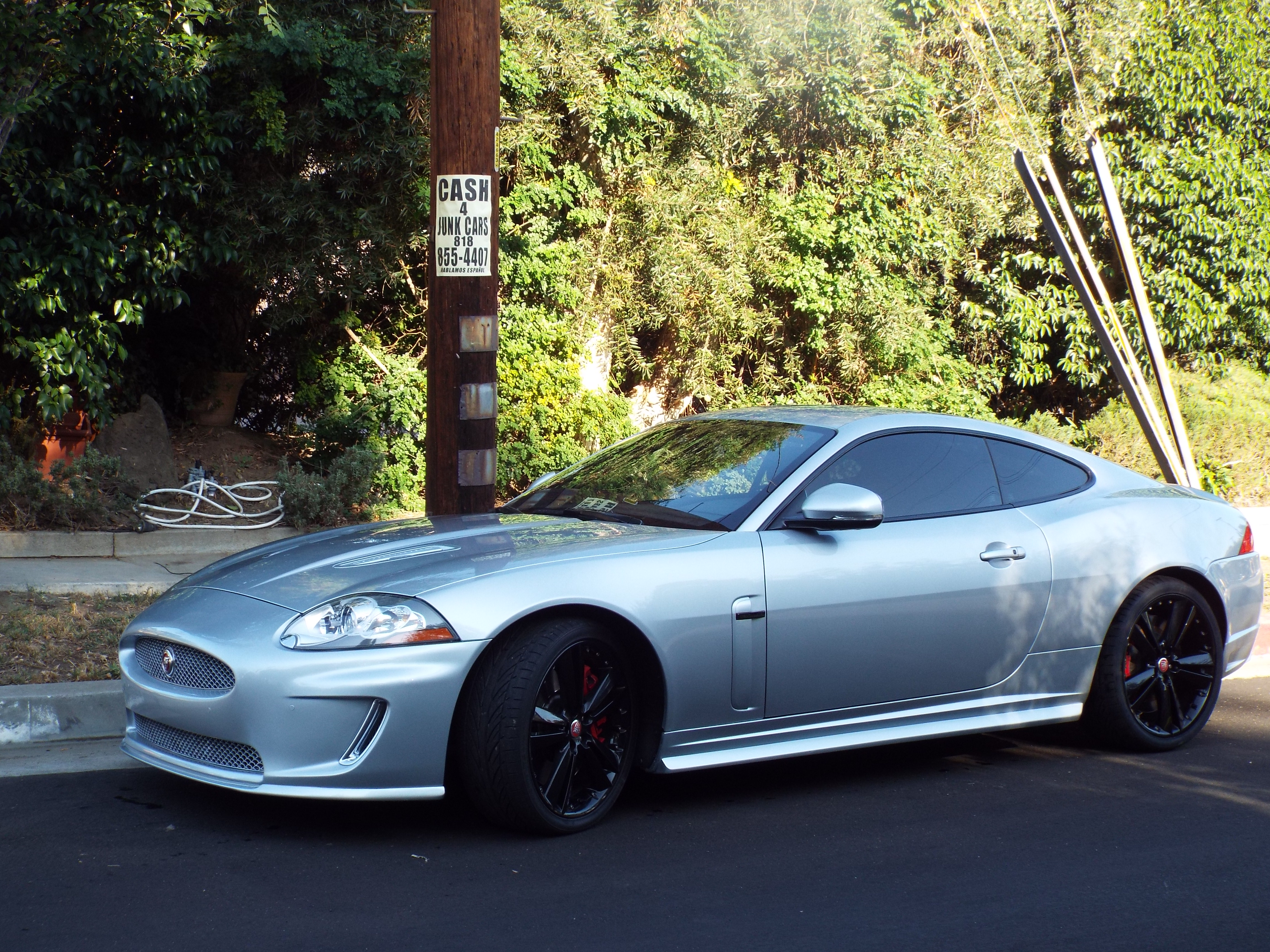

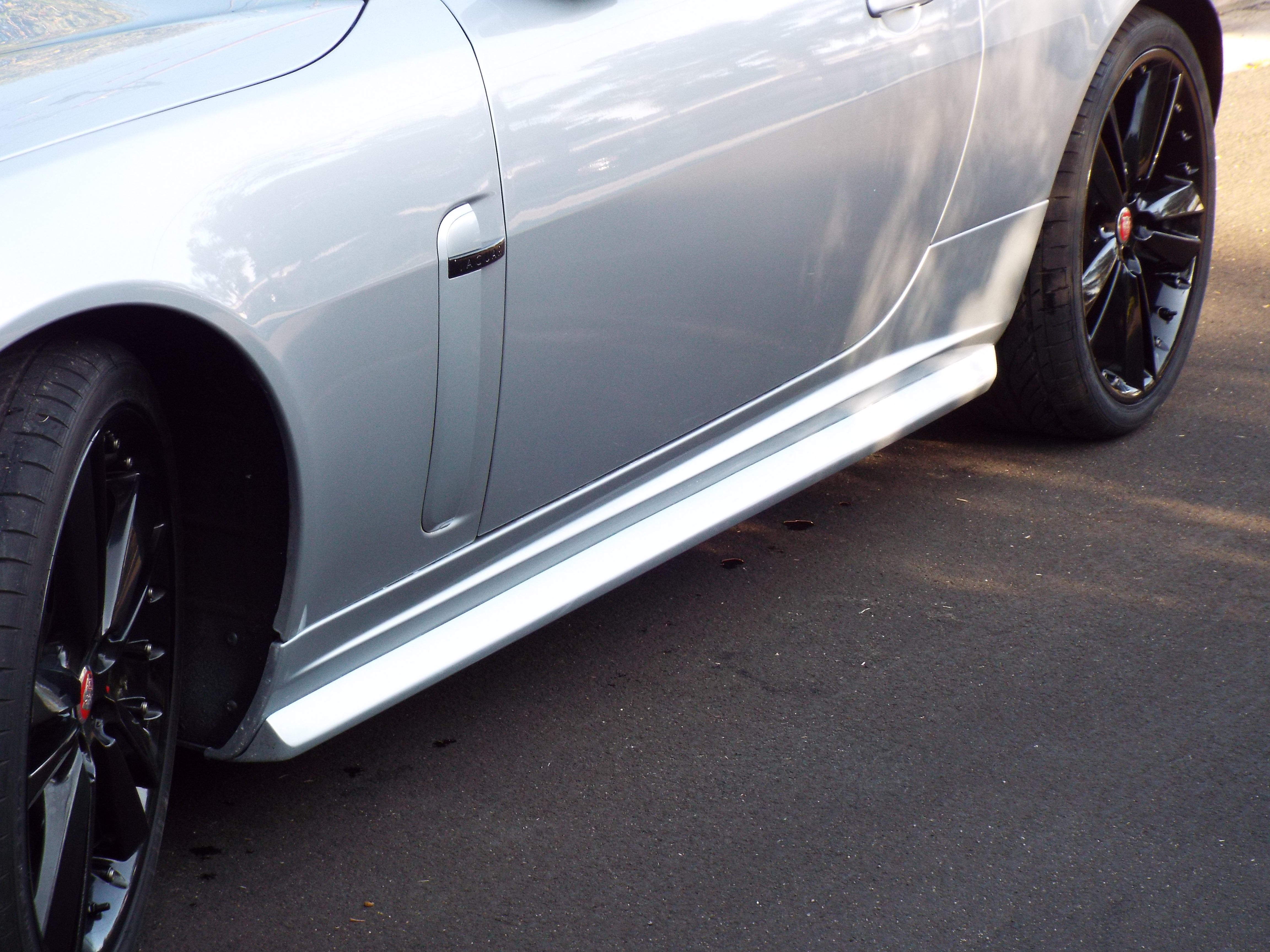

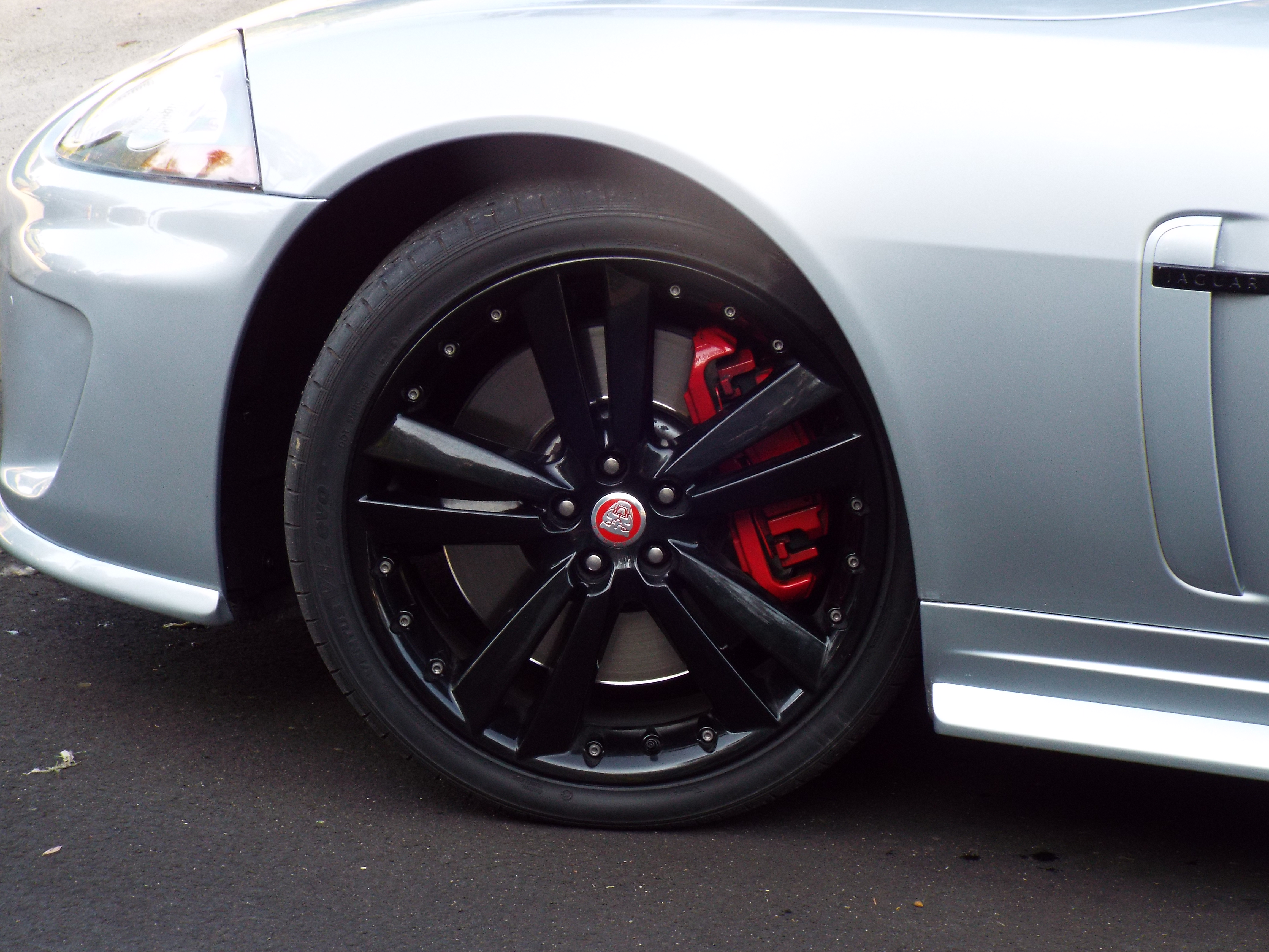

Mr.Nico,
I seem to remember that the side skirts (at least the ones I got from Mina Galleries) bolt on directly to the existing rockers. And these skirts appear to look like those of the XKR175, Are these the skirts you're thinking of adding?
Attached Thumbnails side skirt swap help-dscf1356.jpg   side skirt swap help-dscf1363.jpg   side skirt swap help-dscf1359.jpg

to give a little more info... I have the standard XK150 and purchased the limited edition XK60 side skirts, they are replacement panels rather than bolt on and more or less just an exaggeration of the factory sills (side skirts/ rocker panels) you can see them in these images (that another member posted although mine is the face lifted pre-2012 version so my front and rear bumpers (fenders?) are different)
