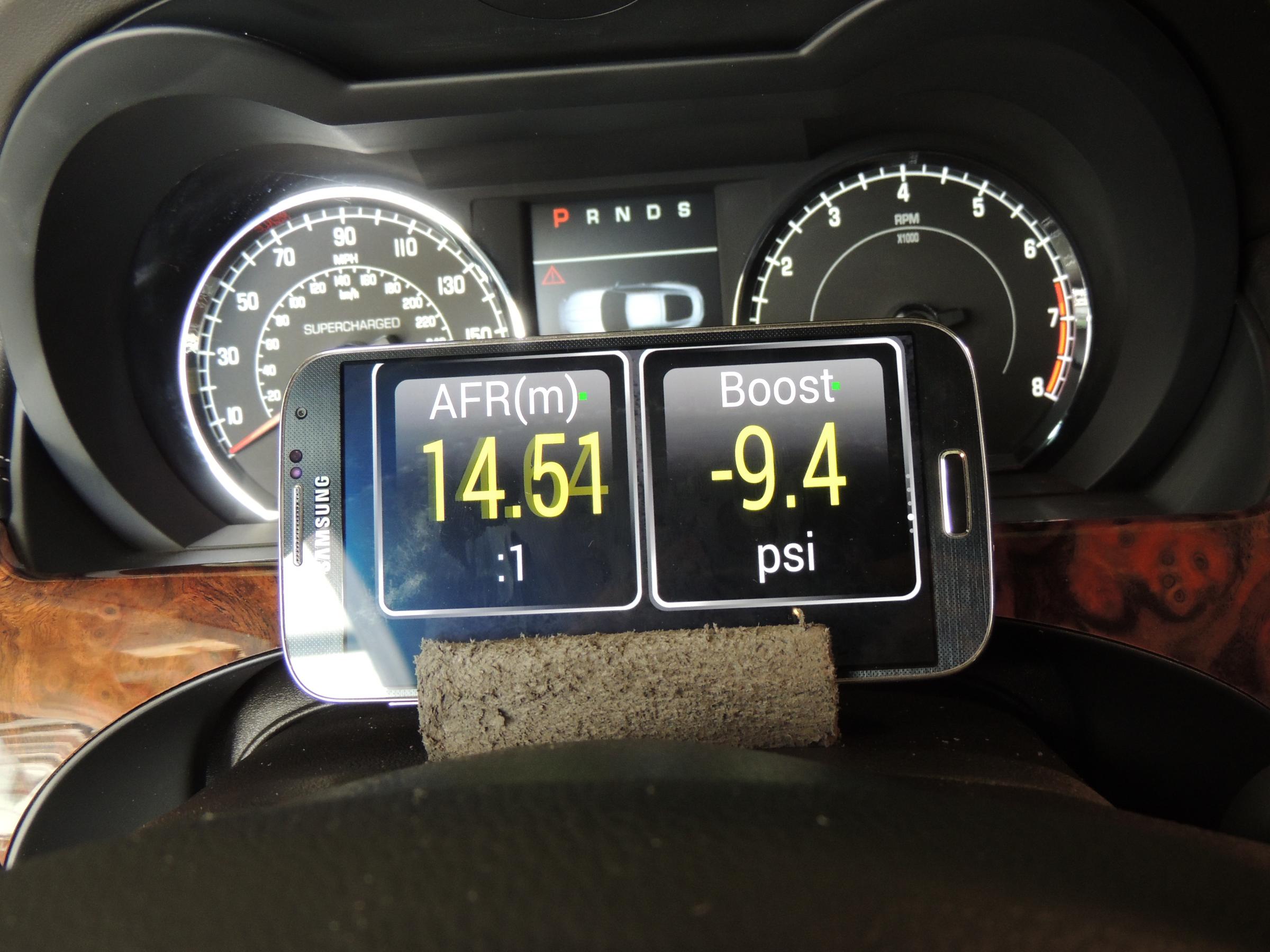

OBD II App for Android
I got my little Bluetooth unit for monitoring OBD II parameters using my Samsung S4 phone. It seems to work superbly. Total cost, $12 for the OBD adapter and $5 for the Torque Pro app from the android app store.
You can swipe between 15 different display windows. Each window can display 6 parameters in different sizes. I got 5 windows set up now to monitor Engine and Transmission temperatures, Boost and AFR (Air Fuel mixture) RPM, Speed, Voltage and Smog parameters and acceleration times for 0-60 and 1/4 miles.
Built a phone holder from minicell foam that goes on top of the steering column and held in place by pinching the soft foam under the dash and the adjustable steering column. Works well, does not go anywhere and it took 5 minutes to make. From my driving position the only blocked view is the lower end of the info screen where I do not see the fuel gauge. If I wish I can display the fuel levels on the phone, as well.
The app also lets you set upper limits for parameters, such as coolant, at which point it will alarm. Very easy to use.
Some pictures are attached.
