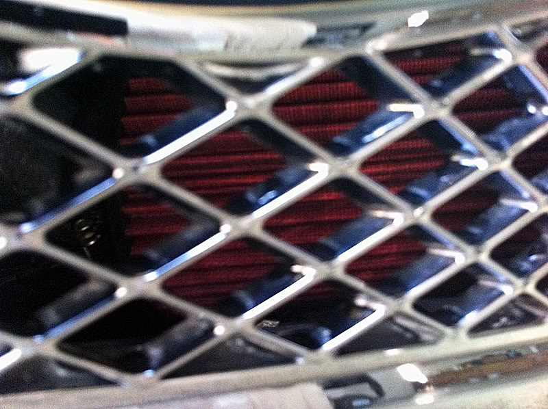

I've had Mina's air intake for my XKR for a year now(approximately 2.5k miles on the air intake) and have no problems with check engine light. Eventhough I didn't see the kit in person as I had it shipped directly to the shop who installed it for me, the shop did advise the kit was actually a decent quality but again it's just tubing with a conincal filter just like any other kits.
My concern also at that time was possibly hydrolock if you go through flooded standing water but again I never drive this car if it's raining (garage queen),only if I get caught coming home and so it's not a big issue for me.
Do I feel any more power from the SOTP? I did feel more punch after I got the car back but again I also did hiflo cats and ECU tune done at the same time as the air intake and so I'm not sure which gave me the more power. Even if it only gave me 5HP, it's 5HP more than I had before. Probably more effective at higher speeds as I'm thinking there would be more of a ram air effect when more air pushing through.
You can see the filter through the mesh underneath the fog light:
