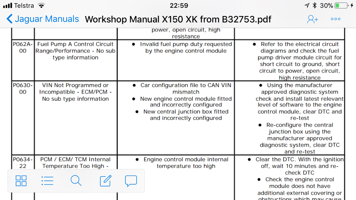

Here's what the workshop manual says
I'd guess that the memory off the PCM has been corrupted...

Did the code / CEL come back after clearing the codes? If so then don't worry about it.
If it did come back then try disconnecting the battery again...
This code is related to the Car Configuration File (CCF) not the engine tune. The CCF does not get modified when a tune is flashed to the car using one of those tuner tools, it's separate to the engine tune.
A copy of the CCF is stored in the PCM, and the information within the CCF is broadcast on the HS-CAN network as well, if the data in those two versions don't match up, it could cause this code.
It's most likely that there was a hiccup after the battery was reconnected, and the PCM was a bit slow to boot up and did not report back the VIN at the requested time.
This fault could occur with a dead-stock car, it's most likely got nothing to do with having a tune in it.
If the fault won't go away, then uploading the CCF to the car again using the dealers diagnostic tool would be the fix.
