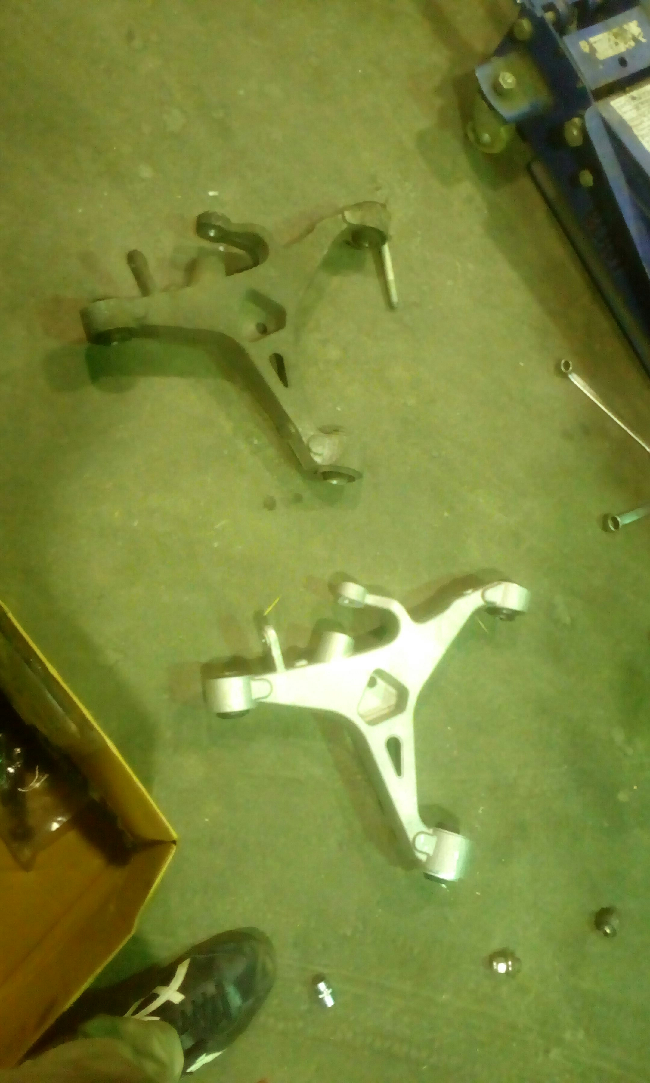

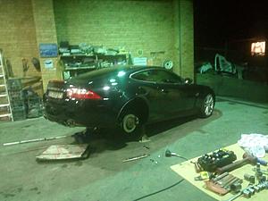

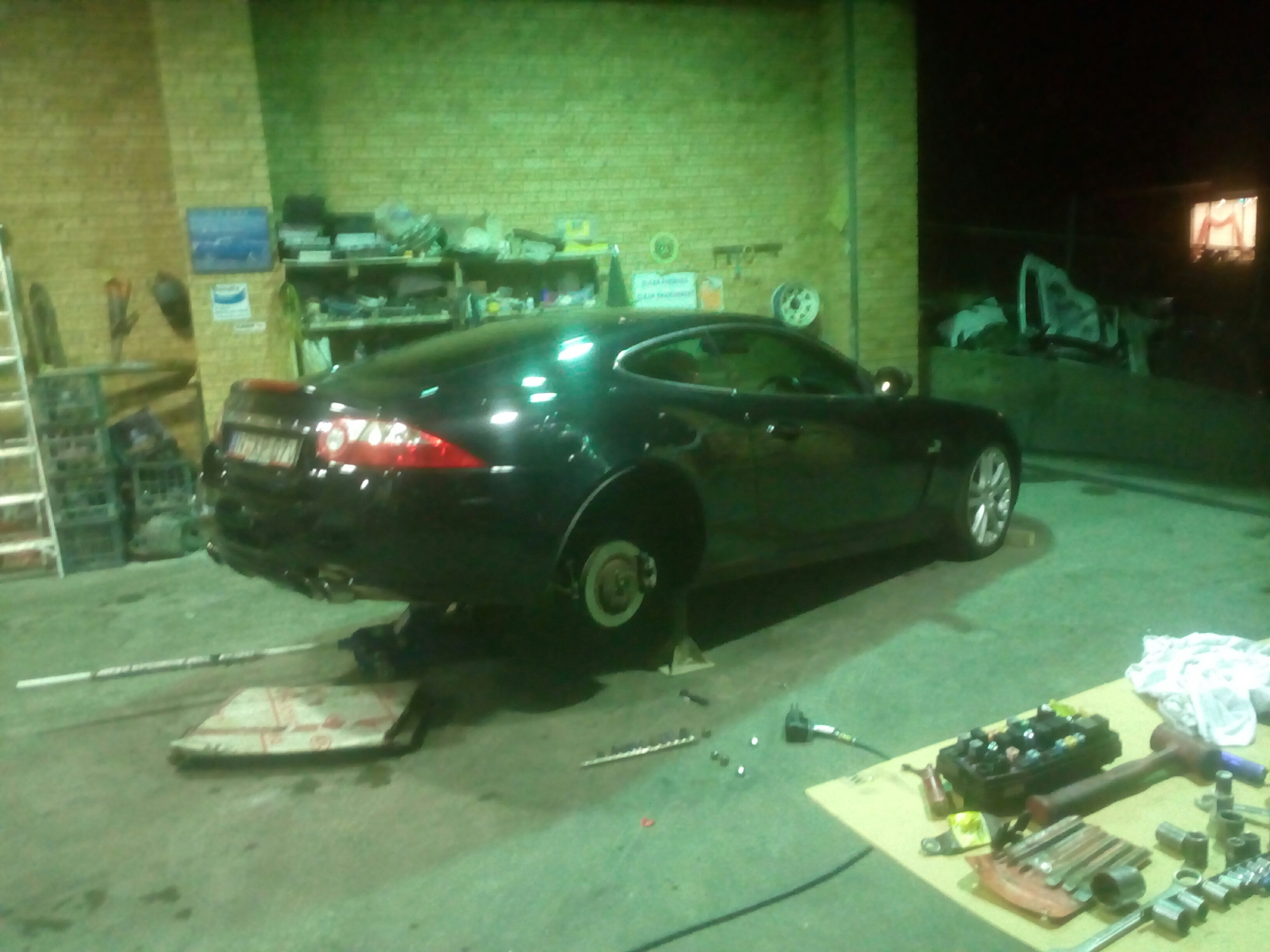

Rear lower control arms and a wash !

Rear lower control arms ... !
Do you have any tips for that job besides consulting the repair manual? I will need to do that in the future.
Stands or hoist
Remove rim
Take the weight of lower control arm with a jack
The caliper will need to be loosened off in order to remove the bolt going through the knuckle so make sure you chock front tyres
Undo the stabiliser link rod (also loosen top nut this will allow more movement)
Remove shock absorber bolt
Now your left with that last two bolts that attach the lower control arm to the rear subframe at this stage you can release the jack and remove the bolt that is closest to the rear of the vehicle
The last bolt is a little tricky to remove the good news is it does come out without dropping the subframe just a lot of spray and wiggling to actually get it out
In terms of installation it's pretty much a reversal however the shock will be the last bolt to go in just use a jack under the lower control arm to position it correctly then insert the bolt
