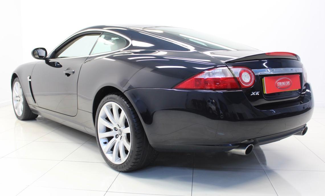

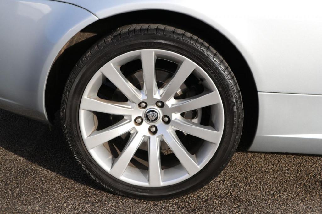

I think they were only fitted as standard to cars that left the factory with 20" wheels. There are a number of XK's on EBAY without them, pics of 2 examples attached.

That makes sense as mine doesn't have them. Made or 'rubber' and held on with 3M tape and fixing clips eh?

The window sticker showed my car came with 20” Sentas, but as a $5k option so that could be why mine didn’t come with the spats?

Mine has 'em stock, Mandrake's 2010 doesn't, I think he has 19" wheels though.

My XKR with the 20" wheels has spats but the one with 19" wheels doesn't. Could'st be they only got stuck on the 20" variants.
