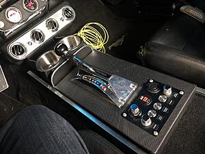

Here is the center console / switch panel I made for my 68 Mustang. I would do my best to make the Jag unit a bit more classy.
X150 XK/XKR audio/speaker upgrade investigation-5r5itcf.jpg
Those control the stereo, amp bass knob, overdrive, fog lights, defrost and electric power steering sensitivity.
