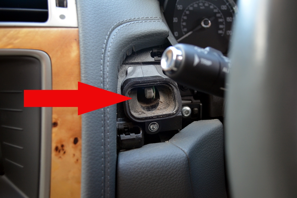

Amazing how much debris collects around this aspirator.
My 2007 XK when I replaced the veneer set.
