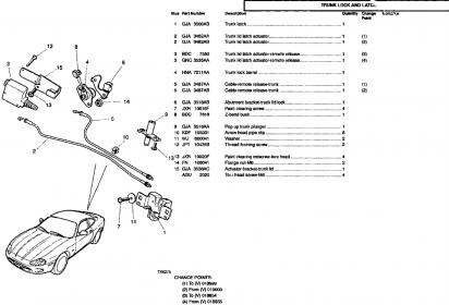

If you look below the right tail light you'll see an XK8 emblem. There's a little hole in the emblem where you can insert your key. Turn the key and the trunk will open.
Here's a picture. Yours may be a little different. I think they changed the design at some point:

the way possible on the xj is not the same as the xk8.
the boot lock is in the body of the car and not the boot itself
so there is no lock mechanism in the boot to attack.
im trying to turn off valet mode by any means possible... i have tried locking and unlocking everything on the car. boot and drivers door.
both key fobs with the vehicle do not work!
the battery in the vehicle is completely dead
even with the vehicle running none of these methods suggested work.
where does the wiring loom from the boot release motor come into the cab of the vehicle and what voltage is a xk8 boot lock? i think the only way is to splice the wiring and add the correct voltage... or...
does anyone have a lock pin for the boot of an xk8?
i think my only option is to beat a couple of wedges under the boot and cut the lock with a disk cutter then manually activate the lock to turn off valet mode with a new battery on the vehicle...
the boot lock barrel seems to be fine... i don't think thats the issue... i think the boot release mechanism itself is faulty as it should open on the key... and i've connected power to every point possible and it still won't open
i even free'd up the valet button as it seems the clips on the side of it squash the casing and grip the button... but still nothing!!!

situation is...
my battery is completely flat.
my valet mode is stuck on.
i believe the boot lock mechanism is broken.
i NEED to open the boot to replace the completely flat battery, to get valet mode off.
i've tried every key and button.
with the vehicle running, power connected to the fuseboard and battery terminals themselves.
pictures of boot locks, mechanisms, wiring looms and catches would be a massive help!
i'm not taking the car to jaguar to fix this issue. i'd rather cut it open and repair the damage.

![Default](/forum/images/icons/icon1.gif)
On the rear of the car next to the X in the XK8 badge you will see a hole for the key to manually open it. If that doesn't work there may be a hole covered with tape behind the license plate to access the mechanism. However, if you've had the car running then it sounds like it may be another problem, maybe a stuck valet switch?
i've tried the key in the lock (turns 90 degrees and makes a satisfying click noise but doesnt open)
the valet switch is free.
i also (this may help alot)
have two sets of two wires hanging down from the 3rd brakelight (inside the boot) with two male 2 pin plugs on them!
i spotted these through the parcel shelf hole (by the fuel pump)
what do these wires do?!?! and where are they suppost to be connected? i have a feeling they lead to my faulty boot lock mechanism!!
where do i reconnect them? (bearing in mind i only have access from the parcel shelf hole!)
i hope this works!

mgnf I know it sounds silly but when you put the key into the XK8 badge on the right side of the boot,which way are you turning the key?because My XK you turn the key to the clockwise,yet funny enough on my in laws Xk you turn it Anti clockwise,very strange I know.but worth a try the opposite way.

ok people are not understanding me correctly...
i know how to start the vehicle by the two terminals under the bonnet.
i know how to start the vehicle by the two terminals in the boot.
i've tried turning my key in the lock every way possible and with as much force as my arms will give out.
its not seized. the key works fine in the lock but will not open the boot
i believe the lock mechanism is broken where the latch is (where the boot and the body meet)
there are two sets of two wires hanging down from what would be the 3rd brake light. are these the boot release mechanism? if so. where do they plug in?

I am not sure but what I found leads me to believe that the key operation of the trunk lock is mechanical, see the attached diagram. #4 is the trunk lock barrel and the #5 cable goes from it to the #1 trunk latch. I would attempt to press down on the trunk as you are turning the key and see if that works. I am not with my car to open and see if that is the case.
I hope this helps!
I hope this helps!
![](https://www.jaguarforums.com/forum/attachments/xk8-xkr-x100-17/4030d1277997359-1999-xk8-stuck-valet-mode-please-help-trunklatch.jpg)
