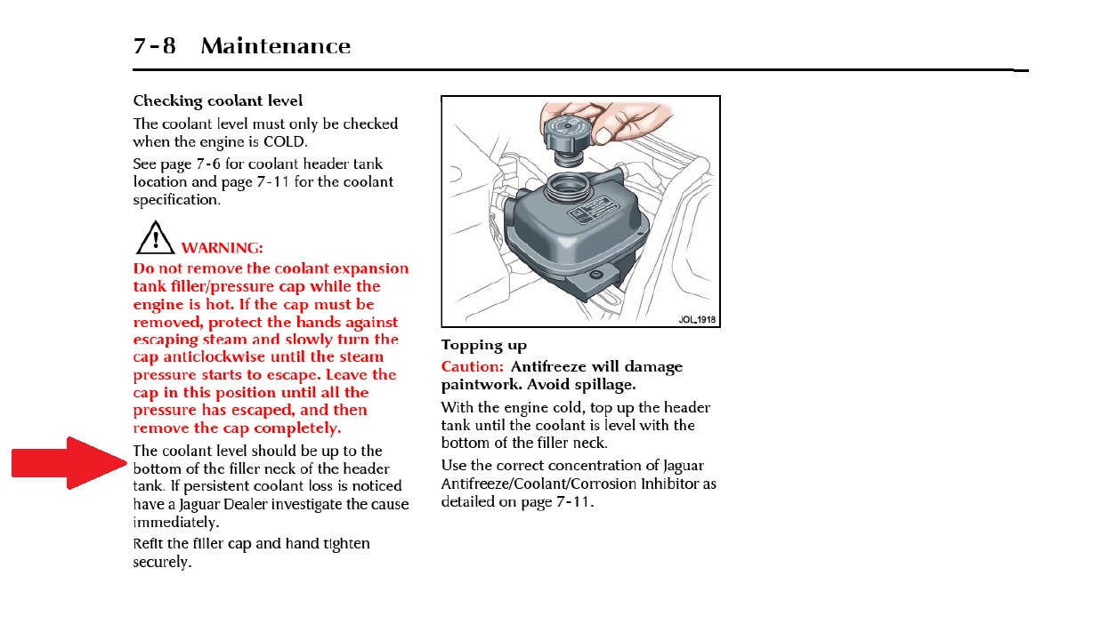

From the Driver's Handbook for your MY:

Yep. I see two small hoses coming off of it. Are there more connections on the bottom or is that it?
It just seemed to me that the expansion tank should have room for expansion when the coolant gets hot and then shrink as it cools. I guess the British do it differently.
